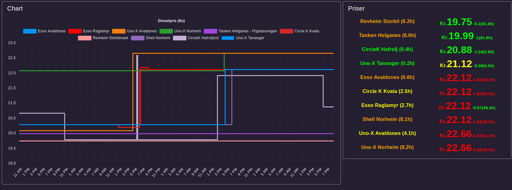

Mitt Dieselprisbilde ser for tiden slik ut:

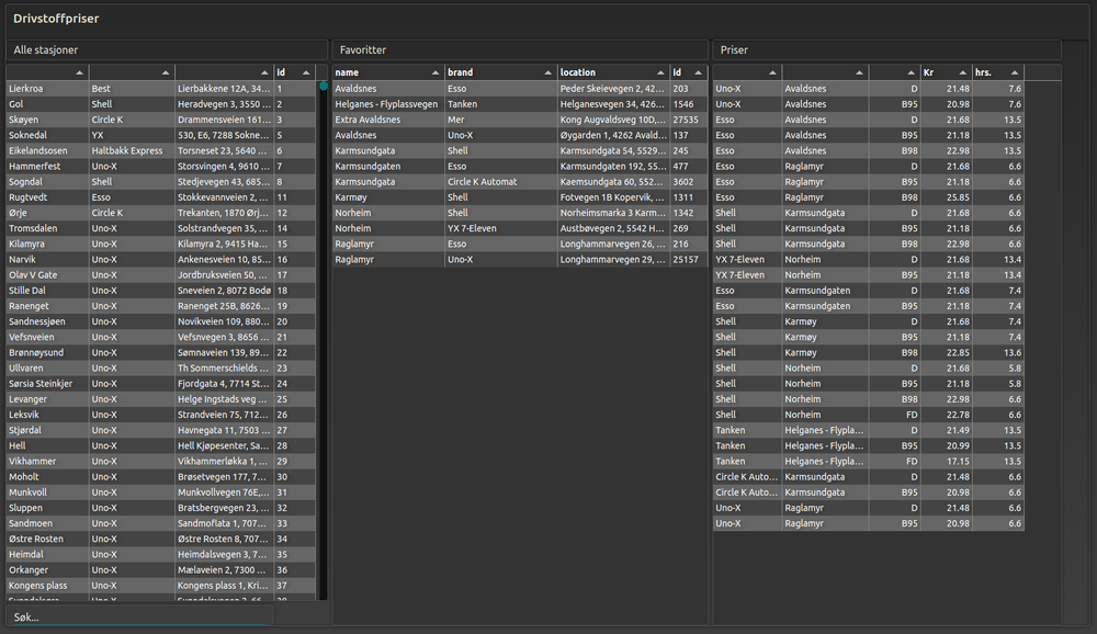

Og et søkbart bilde med mer fleksibelitet men mindre nytteverdi... Her finner en ID som trengs i hovedbildet:

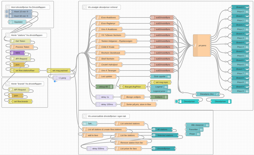

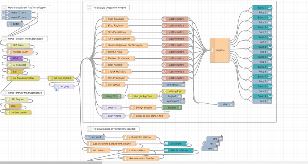

Node-RED Flow:

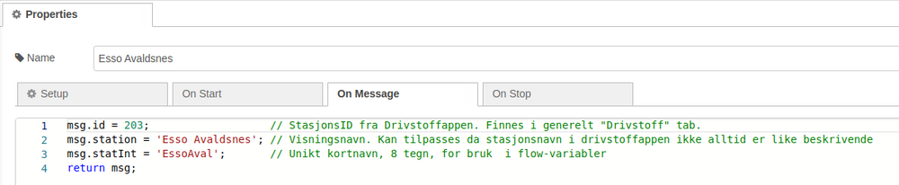

De 10 funksjonsnodene med bensinstasjonsnavn  er det eneste som trenger endres for å tilpasse favorittene. Innholdet er slik:
[{"id":"9103052baf82e5d0","type":"inject","z":"2447f70b5f1095ba","g":"1187eef693a5d073","name":"Hvert 10 min","props":[{"p":"payload"},{"p":"topic","vt":"str"}],"repeat":"","crontab":"*/10 6-23 * * *","once":true,"onceDelay":"5","topic":"","payload":"","payloadType":"date","x":140,"y":80,"wires":[["fb25d94b.139e78"]]},{"id":"c622a1c1b5d187fe","type":"function","z":"2447f70b5f1095ba","g":"516b853f82e2fd07","name":"List all stations & create flow.stations","func":"var brands = flow.get(\"brands\");\nvar statsRaw = flow.get(\"stationsRaw\");\n//flow.set(\"Stations\",msg.payload);\n//node.warn( \"pl.length: \" + statsRaw.length);\nvar arr = [];\nvar arr2 = [];\nvar obj2 = {}\nvar msg2 = {}\nvar i = 0;\nvar j = 0;\nfor (i = 0;i < statsRaw.length;i++){\n    let obj = {}\n    obj.id = statsRaw[i].id;\n//    obj.name = msg.payload[i].name || \"-\"\n//    obj.brand = msg.payload[i].brand || \"-\"\n//    obj.discountInfo = msg.payload[i].discountInfo || \"-\"\n    obj.name = statsRaw[i].name || \"-\"\n    // Find brand from brandId\n    for (j = 0;j < brands.length;j++){\n        if (Number(statsRaw[i].brandId) == Number(brands[j].id)){\n             obj.brand = brands[j].name || \"-\"\n             obj.logo = brands[j].pictureUrl || \"-\"\n             //node.warn(i + \" \" + j + \" \" + brands[j].name);\n             break;\n        }\n    }\n//    obj.brandId = msg.payload[i].brandId || \"-\"\n    obj.location = statsRaw[i].location || \"-\"\n    // Add prices\n    var obj3 = {}\n    //console.log(statsRaw[i].prices.length);\n    for (j = 0;j < statsRaw[i].prices.length;j++){\n        var ftid = statsRaw[i].prices[j].fuelTypeId;\n        if (ftid == 1 && statsRaw[i].prices[j].price != 0){ \n            obj3.D = {}\n            obj3.D.price = statsRaw[i].prices[j].price;\n            obj3.D.lastUpdated = statsRaw[i].prices[j].lastUpdated;\n            obj3.D.type = \"D\";\n        }\n        if (ftid == 2 && statsRaw[i].prices[j].price != 0){ \n            obj3.B95 = {}\n            obj3.B95.price = statsRaw[i].prices[j].price;\n            obj3.B95.lastUpdated = statsRaw[i].prices[j].lastUpdated;\n            obj3.B95.type = \"B95\";\n        } \n        if (ftid == 3 && statsRaw[i].prices[j].price != 0){\n            obj3.B98 = {}\n            obj3.B98.price = statsRaw[i].prices[j].price;\n            obj3.B98.lastUpdated = statsRaw[i].prices[j].lastUpdated;\n            obj3.B98.type = \"B98\";\n        }\n        if (ftid == 4 && statsRaw[i].prices[j].price != 0){\n            obj3.FD = {}\n            obj3.FD.price = statsRaw[i].prices[j].price;\n            obj3.FD.lastUpdated = statsRaw[i].prices[j].lastUpdated;\n            obj3.FD.type = \"FD\";\n        }\n    }\n//    console.log(obj3);\n    obj.prices = obj3;\n\n    \n    arr.push(obj);\n}\nmsg2.payload = arr;\nflow.set(\"stationsPrepd\",arr);\nreturn msg2;","outputs":1,"timeout":"","noerr":0,"initialize":"","finalize":"","libs":[],"x":710,"y":880,"wires":[["6ffebf4f1340a92e","f193882be2dc7762"]]},{"id":"6ffebf4f1340a92e","type":"ui_table","z":"2447f70b5f1095ba","g":"516b853f82e2fd07","group":"0d788a3660f620b1","name":"All stations","order":4,"width":"12","height":"22","columns":[{"field":"name","title":"","width":"26%","align":"left","formatter":"plaintext","formatterParams":{"target":"_blank"}},{"field":"brand","title":"","width":"27%","align":"left","formatter":"plaintext","formatterParams":{"target":"_blank"}},{"field":"location","title":"","width":"31%","align":"left","formatter":"plaintext","formatterParams":{"target":"_blank"}},{"field":"id","title":"id","width":"13%","align":"left","formatter":"plaintext","formatterParams":{"target":"_blank"}}],"outputs":1,"cts":true,"x":1100,"y":880,"wires":[["fc1b2554d6e80f6b"]]},{"id":"fc1b2554d6e80f6b","type":"function","z":"2447f70b5f1095ba","g":"516b853f82e2fd07","name":"add to favs","func":"var favs = flow.get(\"Favs\") || []\nvar pl = msg.payload;\nvar arr = [];\nvar exists = false;\narr = favs;\n\nfor (var i = 0;i < favs.length;i++){\n    if (favs[i].id == pl.id) exists = true;\n}\nif (exists == false) arr.push(pl);\n\nflow.set(\"Favs\", arr);\nreturn msg; ","outputs":1,"timeout":"","noerr":0,"initialize":"","finalize":"","libs":[],"x":630,"y":920,"wires":[["6bfcbbe7c43dcc84"]]},{"id":"5fd3c4e366a636d6","type":"ui_table","z":"2447f70b5f1095ba","g":"516b853f82e2fd07","group":"0d788a3660f620b1","name":"Selected stations","order":5,"width":"14","height":"23","columns":[{"field":"name","title":"name","width":"30%","align":"left","formatter":"plaintext","formatterParams":{"target":"_blank"}},{"field":"brand","title":"brand","width":"30%","align":"left","formatter":"plaintext","formatterParams":{"target":"_blank"}},{"field":"location","title":"location","width":"30%","align":"left","formatter":"plaintext","formatterParams":{"target":"_blank"}},{"field":"id","title":"id","width":"10%","align":"left","formatter":"plaintext","formatterParams":{"target":"_blank"}}],"outputs":1,"cts":true,"x":1120,"y":920,"wires":[["03dc6f5b94c49e02"]]},{"id":"6bfcbbe7c43dcc84","type":"function","z":"2447f70b5f1095ba","g":"516b853f82e2fd07","name":"List fav stations","func":"var favs = flow.get(\"Favs\") || []\nvar arr = []\nvar msg2 = {}\nfor (var i = 0;i < favs.length;i++){\n    let obj = {}\n    obj.id = favs[i].id;\n    obj.name = favs[i].name;\n    obj.brand = favs[i].brand;\n    obj.location = favs[i].location;\n    arr.push(obj);\n}\nmsg2.payload = arr;\nreturn msg2; ","outputs":1,"timeout":"","noerr":0,"initialize":"","finalize":"","libs":[],"x":860,"y":920,"wires":[["5fd3c4e366a636d6","f193882be2dc7762"]]},{"id":"03dc6f5b94c49e02","type":"function","z":"2447f70b5f1095ba","g":"516b853f82e2fd07","name":"Remove station from fav","func":"var i,j = 0;\nvar favs = flow.get(\"Favs\") || []\nvar favs2 = []\nvar remove = msg.payload;\nvar arr = []\nvar msg2 = {}\nfor (i = 0;i < favs.length;i++){\n    if (favs[i].id != remove.id){\n        favs2[j] = favs[i];\n        j++;\n    }\n}\nflow.set(\"Favs\", favs2)\nreturn msg; ","outputs":1,"timeout":"","noerr":0,"initialize":"","finalize":"","libs":[],"x":890,"y":970,"wires":[["6bfcbbe7c43dcc84"]]},{"id":"4d95ecb3e17e80a4","type":"ui_table","z":"2447f70b5f1095ba","g":"516b853f82e2fd07","group":"0d788a3660f620b1","name":"Drivstoffpriser","order":6,"width":"13","height":"23","columns":[{"field":"brand","title":"","width":"20%","align":"left","formatter":"plaintext","formatterParams":{"target":"_blank"}},{"field":"name","title":"","width":"25%","align":"left","formatter":"plaintext","formatterParams":{"target":"_blank"}},{"field":"type","title":"","width":"15%","align":"right","formatter":"plaintext","formatterParams":{"target":"_blank"}},{"field":"price","title":"Kr","width":"15%","align":"right","formatter":"plaintext","formatterParams":{"target":"_blank"}},{"field":"age","title":"hrs.","width":"15%","align":"right","formatter":"plaintext","formatterParams":{"target":"_blank"}}],"outputs":1,"cts":true,"x":1110,"y":1010,"wires":[[]]},{"id":"bf43e528a5851b0d","type":"function","z":"2447f70b5f1095ba","g":"516b853f82e2fd07","name":"List priser for favs","func":"var favs = flow.get(\"Favs\") || []\nvar stats = flow.get(\"stationsPrepd\") || []\nvar arr = []\nvar msg2 = {}\nvar now = Number(new Date());\nvar age = 0;\n\nfor (var i = 0;i < stats.length;i++){   //bla gjennom alle stasjoner\n    for (var j = 0;j < favs.length;j++){    // bla gjennom favoritter\n        if (stats[i].id == favs[j].id){ //er gjeldende stasjon i favoritter?\n//                console.log(stats[i].prices);\n//            for (var k = 0; k < stats[i].prices.length; k++){  // bla gjennom drivstofftyper\n            for (var k in stats[i].prices){  // bla gjennom drivstofftyper\n//                console.log(stats[i].id);\n                let obj = {}\n                obj.name = stats[i].name;\n                obj.brand = stats[i].brand;\n                obj.location = stats[i].location;\n                obj.type = stats[i].prices[k].type;\n                obj.price = stats[i].prices[k].price;\n                obj.age = ((now - stats[i].prices[k].lastUpdated) / 3600 / 1000).toFixed(1);// + \"h\"; //age in hours\n                arr.push(obj);\n            }\n        }\n    }\n}\nmsg2.payload = arr;\nreturn msg2;","outputs":1,"timeout":"","noerr":0,"initialize":"","finalize":"","libs":[],"x":870,"y":1010,"wires":[["4d95ecb3e17e80a4"]]},{"id":"f193882be2dc7762","type":"delay","z":"2447f70b5f1095ba","g":"516b853f82e2fd07","name":"","pauseType":"delay","timeout":"500","timeoutUnits":"milliseconds","rate":"1","nbRateUnits":"1","rateUnits":"second","randomFirst":"1","randomLast":"5","randomUnits":"seconds","drop":false,"allowrate":false,"outputs":1,"x":660,"y":1010,"wires":[["bf43e528a5851b0d"]]},{"id":"d9d0882ba114f2ae","type":"ui_text_input","z":"2447f70b5f1095ba","g":"516b853f82e2fd07","name":"","label":"Søk...","tooltip":"","group":"0d788a3660f620b1","order":7,"width":"10","height":"1","passthru":true,"mode":"text","delay":300,"topic":"topic","sendOnBlur":true,"className":"","topicType":"msg","x":610,"y":840,"wires":[["dd937fc64214f72d"]]},{"id":"dd937fc64214f72d","type":"function","z":"2447f70b5f1095ba","g":"516b853f82e2fd07","name":"List selected stations","func":"var stats = flow.get(\"stationsPrepd\") || []\nvar searchText = msg.payload;\nvar arr = [];\nvar msg2 = {}\nfor (var i = 0;i < stats.length;i++){\n    let obj = {}\n    obj.id = stats[i].id;\n    obj.name = stats[i].name || \"-\"\n    obj.brand = stats[i].brand || \"-\"\n    obj.location = stats[i].location || \"-\"\n    // plukk ut bare stasjoner som inneholder søkebegrepet\n    if (obj.name.includes(searchText) || obj.brand.includes(searchText) || obj.location.includes(searchText)){\n        arr.push(obj);\n    }\n}\nmsg2.payload = arr;\nreturn msg2;","outputs":1,"timeout":"","noerr":0,"initialize":"","finalize":"","libs":[],"x":880,"y":840,"wires":[["6ffebf4f1340a92e"]]},{"id":"13d4a47fe1d5ae74","type":"ui_text","z":"2447f70b5f1095ba","g":"516b853f82e2fd07","group":"0d788a3660f620b1","order":1,"width":"12","height":"1","name":"","label":"Alle stasjoner","format":"{{msg.payload}}","layout":"row-spread","className":"","style":false,"font":"","fontSize":"","color":"#000000","x":1340,"y":850,"wires":[]},{"id":"65cdb903a6486baf","type":"ui_text","z":"2447f70b5f1095ba","g":"516b853f82e2fd07","group":"0d788a3660f620b1","order":2,"width":"14","height":"1","name":"","label":"Favoritter","format":"{{msg.payload}}","layout":"row-spread","className":"","style":false,"font":"","fontSize":"","color":"#000000","x":1320,"y":880,"wires":[]},{"id":"6e102042f9d3270e","type":"ui_text","z":"2447f70b5f1095ba","g":"516b853f82e2fd07","group":"0d788a3660f620b1","order":3,"width":"13","height":"1","name":"","label":"Priser","format":"{{msg.payload}}","layout":"row-spread","className":"","style":false,"font":"","fontSize":"","color":"#000000","x":1310,"y":910,"wires":[]},{"id":"8aef97ddf9f7d1d0","type":"comment","z":"2447f70b5f1095ba","g":"1187eef693a5d073","name":"Hent drivstoffpriser fra Drivstoffappen","info":"","x":190,"y":50,"wires":[]},{"id":"cf5b28121ebac9d8","type":"comment","z":"2447f70b5f1095ba","g":"516b853f82e2fd07","name":"Vis universalliste drivstoffpriser i egen tab","info":"","x":720,"y":790,"wires":[]},{"id":"08c3e48feae420a1","type":"inject","z":"2447f70b5f1095ba","g":"1187eef693a5d073","name":"Hvert 60 min","props":[{"p":"payload"},{"p":"topic","vt":"str"}],"repeat":"","crontab":"0 0-5 * * *","once":true,"onceDelay":"5","topic":"","payload":"","payloadType":"date","x":140,"y":110,"wires":[["fb25d94b.139e78"]]},{"id":"fb25d94b.139e78","type":"http request","z":"2447f70b5f1095ba","g":"19e9dd7c0992a4db","name":"Get Token","method":"GET","ret":"txt","paytoqs":"ignore","url":"https://api.drivstoffappen.no/api/v1/authorization-sessions","tls":"","persist":false,"proxy":"","insecureHTTPParser":false,"authType":"","senderr":false,"headers":[],"x":140,"y":280,"wires":[["9b28d83a.0226d"]]},{"id":"9b28d83a.0226d","type":"function","z":"2447f70b5f1095ba","g":"19e9dd7c0992a4db","name":"Process Token","func":"msg.token = JSON.parse(msg.payload).token;\nmsg.tokenBytes = Buffer.from(msg.token);\nmsg.shiftedBytes = Buffer.concat([msg.tokenBytes.slice(1), msg.tokenBytes.slice(0, 1)]);\nmsg.shiftedToken = msg.shiftedBytes.toString();\nreturn msg;","outputs":1,"timeout":"","noerr":0,"initialize":"","finalize":"","libs":[],"x":150,"y":320,"wires":[["bc5b206f4b80b029"]]},{"id":"bc5b206f4b80b029","type":"md5","z":"2447f70b5f1095ba","g":"19e9dd7c0992a4db","name":"MD5","fieldToHash":"shiftedToken","fieldTypeToHash":"msg","hashField":"md5Hash","hashFieldType":"msg","x":120,"y":360,"wires":[["09f4eac7c81a8f68","372632c4f60d8424"]]},{"id":"36db2ee7d9dbc9dc","type":"json","z":"2447f70b5f1095ba","g":"19e9dd7c0992a4db","name":"","property":"payload","action":"","pretty":false,"x":120,"y":440,"wires":[["029b804564b2042d"]]},{"id":"372632c4f60d8424","type":"http request","z":"2447f70b5f1095ba","g":"66fed02de14cd5a7","name":"API Request","method":"GET","ret":"txt","paytoqs":"ignore","url":"https://api.drivstoffappen.no/api/v1/brands?stationTypeId=1","tls":"","persist":false,"proxy":"","insecureHTTPParser":false,"authType":"","senderr":false,"headers":[{"keyType":"other","keyValue":"X-API-KEY","valueType":"msg","valueValue":"md5Hash"},{"keyType":"other","keyValue":"X-CLIENT-ID","valueType":"other","valueValue":"com.raskebiler.drivstoff.appen.ios"}],"x":130,"y":610,"wires":[["77f438e4db6a6f68"]]},{"id":"77f438e4db6a6f68","type":"json","z":"2447f70b5f1095ba","g":"66fed02de14cd5a7","name":"","property":"payload","action":"","pretty":false,"x":110,"y":650,"wires":[["82d67472bd4bb8a0"]]},{"id":"82d67472bd4bb8a0","type":"change","z":"2447f70b5f1095ba","g":"66fed02de14cd5a7","name":"set flow.brands","rules":[{"t":"set","p":"brands","pt":"flow","to":"payload","tot":"msg"}],"action":"","property":"","from":"","to":"","reg":false,"x":140,"y":690,"wires":[[]]},{"id":"09f4eac7c81a8f68","type":"http request","z":"2447f70b5f1095ba","g":"19e9dd7c0992a4db","name":"API Request","method":"GET","ret":"txt","paytoqs":"ignore","url":"https://api.drivstoffappen.no/api/v1/stations?stationTypeId=1","tls":"","persist":false,"proxy":"","insecureHTTPParser":false,"authType":"","senderr":false,"headers":[{"keyType":"other","keyValue":"X-API-KEY","valueType":"msg","valueValue":"md5Hash"},{"keyType":"other","keyValue":"X-CLIENT-ID","valueType":"other","valueValue":"com.raskebiler.drivstoff.appen.ios"}],"x":140,"y":400,"wires":[["36db2ee7d9dbc9dc"]]},{"id":"32028735556d59eb","type":"comment","z":"2447f70b5f1095ba","g":"66fed02de14cd5a7","name":"Hente \"brands\" fra drivstoffappen","info":"","x":170,"y":570,"wires":[]},{"id":"029b804564b2042d","type":"change","z":"2447f70b5f1095ba","g":"19e9dd7c0992a4db","name":"set flow.stationsRaw","rules":[{"t":"set","p":"stationsRaw","pt":"flow","to":"payload","tot":"msg"}],"action":"","property":"","from":"","to":"","reg":false,"x":170,"y":480,"wires":[["e6a31dc9dfb2064d"]]},{"id":"d9262ca78f365ae0","type":"comment","z":"2447f70b5f1095ba","g":"19e9dd7c0992a4db","name":"Hente \"stations\" fra drivstoffappen","info":"","x":180,"y":240,"wires":[]},{"id":"6d9e547c291b0fbc","type":"delay","z":"2447f70b5f1095ba","name":"+1 gang","pauseType":"delay","timeout":"5","timeoutUnits":"seconds","rate":"1","nbRateUnits":"1","rateUnits":"second","randomFirst":"1","randomLast":"5","randomUnits":"seconds","drop":false,"allowrate":false,"outputs":1,"x":420,"y":530,"wires":[["920c8e464a11c598"]]},{"id":"e6a31dc9dfb2064d","type":"change","z":"2447f70b5f1095ba","name":"","rules":[{"t":"set","p":"payload","pt":"msg","to":"stationsPrepd","tot":"flow"}],"action":"","property":"","from":"","to":"","reg":false,"x":400,"y":480,"wires":[["6d9e547c291b0fbc","920c8e464a11c598","c622a1c1b5d187fe"]]},{"id":"5301761a12ee53d3","type":"ui_button","z":"2447f70b5f1095ba","g":"1187eef693a5d073","name":"","group":"c5147f5beba7be52","order":23,"width":"3","height":"2","passthru":false,"label":"Oppdater","tooltip":"","color":"","bgcolor":"","className":"","icon":"","payload":"","payloadType":"str","topic":"topic","topicType":"msg","x":120,"y":150,"wires":[["fb25d94b.139e78"]]},{"id":"77e67d4e89c2c546","type":"group","z":"2447f70b5f1095ba","style":{"stroke":"#999999","stroke-opacity":"1","fill":"none","fill-opacity":"1","label":true,"label-position":"nw","color":"#a4a4a4"},"nodes":["dc20c0baebcded39","52943a1fc077d28f","7014c2032a87fc3b","671050bdedc0c3cb","8e502b90702d3857","b1eaf76d80b124b2","13527989f83e29d2","a789bc33845b6aae","28fe85a134fe0971","dfb010ed7eafaf57","f10d3ac86fabfb52","4fdfe701f4a3afa0","920c8e464a11c598","80fadd7556b173c2","a25c248dc4ebd8e1","4845524c229e5de4","4bc7a1bfe0edbd3d","a0ed1589c7578ebc","313d717f04abb611","df6111373c9fcb74","9115f8c79d2fb5bf","bb875534cb2f1287","ef238c7de03c89ba","342412d6ccffa890","deb634361ea88282","7d2c0b671fe55eb5","73f01377bb3987bb","2ca32bed009a91c7","c4e4ad48e1be3967","fedddf6d961e47e1","f004caf9b1859658","f280cce61136ea5f","35afefb923880a86","13a80ea70008ef69","de080617e02b76c0","efb09c551659ae8e","c9be417364a0636a","c1e1c529d2ebbbe3","ba85ec803b447086","575ebc0b7826b668","a5b30e2c9a5b185b","5cdf4a4e44ba3e96","7907e0a5a1ff80b6","ee11d26aa7381961","c6597ae705c493fd","197fde062f906fe2","d3117ab9bbdc344d","a76caa7a16bac95c","99fbdbd6f1247a74","f41e2331b0b830d3","98ad46a8c1cec362","b4db27ab8e1249f9","211a49ea39c47dbf","345e2bc8bcaeeffd","f3a5b1da15641fda","f82266bbecc5f929","7ec8a975f4e62ea5","b4c42883c0d1b421","89f905a2a16a5653","bd92fd80ba8708f5","919354dd3a9d85e1","af920dde227a02ba","42965b35532dc0a6","198ea5a17cf29258","591771770c56781a","72b2d1bb06c9fd47","835b0df2bd3edcbb","69d3c375167219d4","e329d720082ab3ca"],"x":534,"y":9,"w":1182,"h":742},{"id":"2835c4be2e0c346c","type":"subflow","name":"subDrivstoffpris","info":"","category":"","in":[{"x":60,"y":80,"wires":[{"id":"629ced2da13dc595"}]}],"out":[{"x":440,"y":50,"wires":[{"id":"629ced2da13dc595","port":0}]},{"x":440,"y":110,"wires":[{"id":"629ced2da13dc595","port":1}]}],"env":[{"name":"station","type":"str","value":""},{"name":"statInt","type":"str","value":""},{"name":"statInt_Prev","type":"str","value":""}],"meta":{"version":"1.0","author":"SveinHa"},"color":"#DDAA99","outputLabels":["Trend","Skilt"]},{"id":"629ced2da13dc595","type":"function","z":"2835c4be2e0c346c","name":"Hjernen ;-)","func":"let sid = msg.id;\nvar station = msg.station;\nvar statInt = msg.statInt;\n//var statInt_Prev = statInt_Prev;\n\nvar prev = 0;\nvar diff = 0;\nvar msg2 = {}\n//console.log(msg.payload);\n//msg.payload = msg.payload.filter((/** @type {{ id: string; }} */ e) => e.id == sid);\nmsg.payload = msg.payload.filter((e) => e.id == sid);\n//console.log(msg.payload[0].brandId);\n//node.warn(msg);\n\n//msg.payload = msg.payload.filter((/** @type {{ discountInfo: string; }} */ e) => e.discountInfo == station); \n//console.log(msg.payload[0].prices.D.type);\n//msg.payload[0].type = msg.payload[0].prices.D.type;//.filter(e => e.type == 'D');\nvar price = msg.payload[0].prices.D.price;\n//console.log(price);\nvar now = Number(new Date());\nvar age = (now - msg.payload[0].prices.D.lastUpdated) / 3600 / 1000; //age in hours\nvar diffSymbol = \"\";\nflow.set(\"$parent.\" + statInt, price);\nprev = flow.get(\"$parent.\" + statInt + \"_Prev\") || 0\n\n//node.warn(\"ID: \" + msg.payload[0].id + \", name: \" + msg.payload[0].name + \", brand: \" + msg.payload[0].brand );\n\nvar snitt = flow.get(\"$parent.AvgPrice\");\nvar min = flow.get(\"$parent.MinPrice\");\nvar max = flow.get(\"$parent.MaxPrice\");\nvar lolim = snitt - ((max - min)/6);\nvar hilim = snitt + ((max - min)/6);\nif (price < lolim) msg2.color = \"LIME\";\nelse if (price > hilim) msg2.color = \"RED\";\nelse msg2.color = \"YELLOW\";\n//node.warn(min + \"-\" + lolim + \"-\" + snitt + \"-\" + hilim + \"-\" + max);\n\nif (price != prev) {\n    var ts = new Date();\n    flow.set(\"$parent.\" + statInt + \"_Diff\", Number((price - prev).toFixed(2)));\n    flow.set(\"$parent.\" + statInt + \"_Prev\", price);\n    flow.set(\"$parent.\" + statInt + \"_PrevT\", Number(ts));\n}\n\ndiff = flow.get(\"$parent.\" + statInt + \"_Diff\") || \"-\"\nvar tss = flow.get(\"$parent.\" + statInt + \"_PrevT\") || 0\nvar ageD = Number((Number(now) - Number(tss))) / 3600 / 1000; //age in hours\nif (ageD > 999.9) ageD = 999.9;\n\nif (diff >= 0) diffSymbol = \"<font color=RED> \" + diff;//.toFixed(2);\nelse diffSymbol = \"<font color=LIME> \" + diff;//.toFixed(2);\nflow.set(\"$parent.\" + statInt + \"_DiffS\", diffSymbol);\n\ndiffSymbol = flow.get(\"$parent.\" + statInt + \"_DiffS\") || \"-\"\nmsg2.payload = \"<font size=6>\" + price.toFixed(2) + \"<font size=2>\" + diffSymbol + \"(\" + ageD.toFixed(1) + \"h)\";\nmsg2.topic = station.slice(0,15);    //Forkort for lange navn\nmsg2.age = age.toFixed(1);\nif (age < 1) { msg2.stationcolor = \"LIME\"; }\nelse if (age < 6) { msg2.stationcolor = \"YELLOW\"; }\nelse if (age <= 12) { msg2.stationcolor = \"ORANGE\"; }\nelse if (age > 12) { msg2.stationcolor = \"RED\"; }\n\n//node.warn(msg2.topic + \"Price: \" + price + \" Prev: \" + prev + \"Diff: \" + diff);\nmsg2.pri  = flow.get(\"$parent.\" + statInt + \"_Pri\") \n//node.send([null,msg2]);\n//node.warn(\"$parent.\" + statInt + \"-\" + msg2.pri);\nmsg2.src = msg.payload[0].logo;\n\nmsg.payload = Number(price.toFixed(2));\nmsg.topic = station;\n\nreturn [msg, msg2];","outputs":2,"timeout":"","noerr":0,"initialize":"","finalize":"","libs":[],"x":220,"y":80,"wires":[[],[]]},{"id":"dc20c0baebcded39","type":"persist in","z":"2447f70b5f1095ba","g":"77e67d4e89c2c546","name":"Dieselpriser","storageNode":"8a6654beead70801","x":1500,"y":690,"wires":[]},{"id":"52943a1fc077d28f","type":"persist out","z":"2447f70b5f1095ba","g":"77e67d4e89c2c546","name":"Dieselpriser","storageNode":"8a6654beead70801","x":1280,"y":690,"wires":[["835b0df2bd3edcbb"]]},{"id":"7014c2032a87fc3b","type":"ui_text","z":"2447f70b5f1095ba","g":"77e67d4e89c2c546","group":"c5147f5beba7be52","order":5,"width":"6","height":"2","name":"Price 1","label":"<font color=\"{{msg.stationcolor}}\">{{msg.topic}} ({{msg.age}}h)","format":"<font color=\"{{msg.color}}\">Kr.{{msg.payload}}","layout":"col-center","className":"","style":false,"font":"","fontSize":"","color":"#000000","x":1630,"y":140,"wires":[]},{"id":"671050bdedc0c3cb","type":"ui_text","z":"2447f70b5f1095ba","g":"77e67d4e89c2c546","group":"c5147f5beba7be52","order":15,"width":"6","height":"2","name":"Price 6","label":"<font color=\"{{msg.stationcolor}}\">{{msg.topic}} ({{msg.age}}h)","format":"<font color=\"{{msg.color}}\">Kr.{{msg.payload}}","layout":"col-center","className":"","style":false,"font":"","fontSize":"","color":"#000000","x":1630,"y":440,"wires":[]},{"id":"8e502b90702d3857","type":"ui_text","z":"2447f70b5f1095ba","g":"77e67d4e89c2c546","group":"c5147f5beba7be52","order":17,"width":"6","height":"2","name":"Price 7","label":"<font color=\"{{msg.stationcolor}}\">{{msg.topic}} ({{msg.age}}h)","format":"<font color=\"{{msg.color}}\">Kr.{{msg.payload}}","layout":"col-center","className":"","style":false,"font":"","fontSize":"","color":"#000000","x":1630,"y":500,"wires":[]},{"id":"b1eaf76d80b124b2","type":"ui_text","z":"2447f70b5f1095ba","g":"77e67d4e89c2c546","group":"c5147f5beba7be52","order":13,"width":"6","height":"2","name":"Price 5","label":"<font color=\"{{msg.stationcolor}}\">{{msg.topic}} ({{msg.age}}h)","format":"<font color=\"{{msg.color}}\">Kr.{{msg.payload}}","layout":"col-center","className":"","style":false,"font":"","fontSize":"","color":"#000000","x":1630,"y":380,"wires":[]},{"id":"13527989f83e29d2","type":"ui_text","z":"2447f70b5f1095ba","g":"77e67d4e89c2c546","group":"c5147f5beba7be52","order":3,"width":"6","height":"2","name":"Price 0","label":"<font color=\"{{msg.stationcolor}}\">{{msg.topic}} ({{msg.age}}h)","format":"<font color=\"{{msg.color}}\">Kr.{{msg.payload}}","layout":"col-center","className":"","style":false,"font":"","fontSize":"","color":"#000000","x":1630,"y":80,"wires":[]},{"id":"a789bc33845b6aae","type":"ui_text","z":"2447f70b5f1095ba","g":"77e67d4e89c2c546","group":"c5147f5beba7be52","order":9,"width":"6","height":"2","name":"Price 3","label":"<font color=\"{{msg.stationcolor}}\">{{msg.topic}} ({{msg.age}}h)","format":"<font color=\"{{msg.color}}\">Kr.{{msg.payload}}","layout":"col-center","className":"","style":false,"font":"","fontSize":"","color":"#000000","x":1630,"y":260,"wires":[]},{"id":"28fe85a134fe0971","type":"debug","z":"2447f70b5f1095ba","g":"77e67d4e89c2c546","name":"debug 89","active":false,"tosidebar":true,"console":false,"tostatus":false,"complete":"true","targetType":"full","statusVal":"","statusType":"auto","x":710,"y":590,"wires":[]},{"id":"dfb010ed7eafaf57","type":"function","z":"2447f70b5f1095ba","g":"77e67d4e89c2c546","name":"Last update","func":"msg.label = \"Siste oppdatering\";\n//var d = new Date(msg.headers.date);\nvar d = new Date();\n//node.warn(d);\nmsg.payload = d.toLocaleString('nb-NO' );//.slice(0,16);\n//node.warn(msg.payload);\nreturn msg;","outputs":1,"timeout":"","noerr":0,"initialize":"","finalize":"","libs":[],"x":720,"y":520,"wires":[["f10d3ac86fabfb52","a25c248dc4ebd8e1"]]},{"id":"f10d3ac86fabfb52","type":"ui_text","z":"2447f70b5f1095ba","g":"77e67d4e89c2c546","group":"c5147f5beba7be52","order":24,"width":"6","height":"2","name":"Siste oppdat","label":"{{msg.label}}","format":"{{msg.payload}}","layout":"row-left","className":"","style":false,"font":"","fontSize":"","color":"#000000","x":1090,"y":520,"wires":[]},{"id":"4fdfe701f4a3afa0","type":"comment","z":"2447f70b5f1095ba","g":"77e67d4e89c2c546","name":"Vis utvalgte dieselpriser m/trend","info":"","x":690,"y":50,"wires":[]},{"id":"920c8e464a11c598","type":"junction","z":"2447f70b5f1095ba","g":"77e67d4e89c2c546","x":560,"y":360,"wires":[["28fe85a134fe0971","dfb010ed7eafaf57","313d717f04abb611","7d2c0b671fe55eb5","9115f8c79d2fb5bf","bb875534cb2f1287","ef238c7de03c89ba","342412d6ccffa890","deb634361ea88282","73f01377bb3987bb","efb09c551659ae8e","c1e1c529d2ebbbe3","7907e0a5a1ff80b6","72b2d1bb06c9fd47"]]},{"id":"80fadd7556b173c2","type":"ui_text","z":"2447f70b5f1095ba","g":"77e67d4e89c2c546","group":"c5147f5beba7be52","order":25,"width":"6","height":"1","name":"Legend","label":"<font color=\"LIME\"><1h <font color=\"YELLOW\"><6h <font color=\"ORANGE\"><=12h <font color=\"RED\">>12h<font color=#43464B>","format":"","layout":"row-left","className":"","style":false,"font":"","fontSize":"","color":"#000000","x":1080,"y":590,"wires":[]},{"id":"a25c248dc4ebd8e1","type":"change","z":"2447f70b5f1095ba","g":"77e67d4e89c2c546","name":"flow.get.AvgPrice","rules":[{"t":"set","p":"payload","pt":"msg","to":"AvgPrice","tot":"flow"}],"action":"","property":"","from":"","to":"","reg":false,"x":900,"y":590,"wires":[["80fadd7556b173c2","4845524c229e5de4","575ebc0b7826b668"]]},{"id":"4845524c229e5de4","type":"change","z":"2447f70b5f1095ba","g":"77e67d4e89c2c546","name":"","rules":[{"t":"set","p":"topic","pt":"msg","to":"Snitt","tot":"str"}],"action":"","property":"","from":"","to":"","reg":false,"x":1090,"y":560,"wires":[[]]},{"id":"4bc7a1bfe0edbd3d","type":"ui_text","z":"2447f70b5f1095ba","g":"77e67d4e89c2c546","group":"c5147f5beba7be52","order":7,"width":"6","height":"2","name":"Price 2","label":"<font color=\"{{msg.stationcolor}}\">{{msg.topic}} ({{msg.age}}h)","format":"<font color=\"{{msg.color}}\">Kr.{{msg.payload}}","layout":"col-center","className":"","style":false,"font":"","fontSize":"","color":"#000000","x":1630,"y":200,"wires":[]},{"id":"a0ed1589c7578ebc","type":"ui_text","z":"2447f70b5f1095ba","g":"77e67d4e89c2c546","group":"c5147f5beba7be52","order":11,"width":"6","height":"2","name":"Price 4","label":"<font color=\"{{msg.stationcolor}}\">{{msg.topic}} ({{msg.age}}h)","format":"<font color=\"{{msg.color}}\">Kr.{{msg.payload}}","layout":"col-center","className":"","style":false,"font":"","fontSize":"","color":"#000000","x":1630,"y":320,"wires":[]},{"id":"313d717f04abb611","type":"function","z":"2447f70b5f1095ba","g":"77e67d4e89c2c546","name":"Esso Avaldsnes","func":"msg.id = 203;                   // StasjonsID fra Drivstoffappen. Finnes i generelt \"Drivstoff\" tab.\nmsg.station = 'Esso Avaldsnes'; // Visningsnavn. Kan tilpasses da stasjonsnavn i drivstoffappen ikke alltid er like beskrivende\nmsg.statInt = 'EssoAval';       // Unikt kortnavn, 8 tegn, for bruk  i flow-variabler\nreturn msg;","outputs":1,"timeout":"","noerr":0,"initialize":"","finalize":"","libs":[],"x":730,"y":120,"wires":[["df6111373c9fcb74"]]},{"id":"df6111373c9fcb74","type":"subflow:2835c4be2e0c346c","z":"2447f70b5f1095ba","g":"77e67d4e89c2c546","name":"","x":1100,"y":120,"wires":[["69d3c375167219d4"],["e329d720082ab3ca"]]},{"id":"9115f8c79d2fb5bf","type":"function","z":"2447f70b5f1095ba","g":"77e67d4e89c2c546","name":"Uno-X Avaldsnes","func":"msg.id = 137;                       // StasjonsID fra Drivstoffappen. Finnes i generelt \"Drivstoff\" tab.\nmsg.station = 'Uno-X Avaldsnes';    // Visningsnavn. Kan tilpasses da stasjonsnavn i drivstoffappen ikke alltid er like beskrivende\nmsg.statInt = 'UnoXAval';           // Unikt kortnavn, 8 tegn, for bruk  i flow-variabler\nreturn msg;","outputs":1,"timeout":"","noerr":0,"initialize":"","finalize":"","libs":[],"x":740,"y":200,"wires":[["c4e4ad48e1be3967"]]},{"id":"bb875534cb2f1287","type":"function","z":"2447f70b5f1095ba","g":"77e67d4e89c2c546","name":"YX 7-Eleven Norheim","func":"msg.id = 269;                           // StasjonsID fra Drivstoffappen. Finnes i generelt \"Drivstoff\" tab.\nmsg.station = 'YX 7-Eleven Norheim';    // Visningsnavn. Kan tilpasses da stasjonsnavn i drivstoffappen ikke alltid er like beskrivende\nmsg.statInt = 'YX7ENorh';               // Unikt kortnavn, 8 tegn, for bruk  i flow-variabler\nreturn msg;","outputs":1,"timeout":"","noerr":0,"initialize":"","finalize":"","libs":[],"x":750,"y":240,"wires":[["fedddf6d961e47e1"]]},{"id":"ef238c7de03c89ba","type":"function","z":"2447f70b5f1095ba","g":"77e67d4e89c2c546","name":"Tanken Helganes - Flyplassvegen","func":"msg.id = 1546;                                      // StasjonsID fra Drivstoffappen. Finnes i generelt \"Drivstoff\" tab.\nmsg.station = 'Tanken Helganes - Flyplassvegen';    // Visningsnavn. Kan tilpasses da stasjonsnavn i drivstoffappen ikke alltid er like beskrivende\nmsg.statInt = 'TankFlyp';                           // Unikt kortnavn, 8 tegn, for bruk  i flow-variabler\nreturn msg;","outputs":1,"timeout":"","noerr":0,"initialize":"","finalize":"","libs":[],"x":790,"y":280,"wires":[["f004caf9b1859658"]]},{"id":"342412d6ccffa890","type":"function","z":"2447f70b5f1095ba","g":"77e67d4e89c2c546","name":"Cirkle K Kvala","func":"msg.id = 187;                   // StasjonsID fra Drivstoffappen. Finnes i generelt \"Drivstoff\" tab.\nmsg.station = 'Circle K Kvala'; // Visningsnavn. Kan tilpasses da stasjonsnavn i drivstoffappen ikke alltid er like beskrivende\nmsg.statInt = 'CirKKval';       // Unikt kortnavn, 8 tegn, for bruk  i flow-variabler\nreturn msg;","outputs":1,"timeout":"","noerr":0,"initialize":"","finalize":"","libs":[],"x":730,"y":320,"wires":[["f280cce61136ea5f"]]},{"id":"deb634361ea88282","type":"function","z":"2447f70b5f1095ba","g":"77e67d4e89c2c546","name":"Revheim Storbilvask","func":"msg.id = 22828;                         // StasjonsID fra Drivstoffappen. Finnes i generelt \"Drivstoff\" tab.\nmsg.station = 'Revheim Storbilvask';    // Visningsnavn. Kan tilpasses da stasjonsnavn i drivstoffappen ikke alltid er like beskrivende\nmsg.statInt = 'RevhStor';               // Unikt kortnavn, 8 tegn, for bruk  i flow-variabler\nreturn msg;","outputs":1,"timeout":"","noerr":0,"initialize":"","finalize":"","libs":[],"x":750,"y":360,"wires":[["35afefb923880a86"]]},{"id":"7d2c0b671fe55eb5","type":"function","z":"2447f70b5f1095ba","g":"77e67d4e89c2c546","name":"Esso Raglamyr","func":"msg.id = 216;                   // StasjonsID fra Drivstoffappen. Finnes i generelt \"Drivstoff\" tab.\nmsg.station = 'Esso Raglamyr';  // Visningsnavn. Kan tilpasses da stasjonsnavn i drivstoffappen ikke alltid er like beskrivende\nmsg.statInt = 'EssoRagl';       // Unikt kortnavn, 8 tegn, for bruk  i flow-variabler\nreturn msg;","outputs":1,"timeout":"","noerr":0,"initialize":"","finalize":"","libs":[],"x":730,"y":160,"wires":[["2ca32bed009a91c7"]]},{"id":"73f01377bb3987bb","type":"function","z":"2447f70b5f1095ba","g":"77e67d4e89c2c546","name":"Shell Norheim","func":"msg.id = 1342;                  // StasjonsID fra Drivstoffappen. Finnes i generelt \"Drivstoff\" tab.\nmsg.station = 'Shell Norheim';  // Visningsnavn. Kan tilpasses da stasjonsnavn i drivstoffappen ikke alltid er like beskrivende\nmsg.statInt = 'ShelNorh';       // Unikt kortnavn, 8 tegn, for bruk  i flow-variabler\nreturn msg;","outputs":1,"timeout":"","noerr":0,"initialize":"","finalize":"","libs":[],"x":730,"y":400,"wires":[["13a80ea70008ef69"]]},{"id":"2ca32bed009a91c7","type":"subflow:2835c4be2e0c346c","z":"2447f70b5f1095ba","g":"77e67d4e89c2c546","name":"","x":1100,"y":160,"wires":[["69d3c375167219d4"],["e329d720082ab3ca"]]},{"id":"c4e4ad48e1be3967","type":"subflow:2835c4be2e0c346c","z":"2447f70b5f1095ba","g":"77e67d4e89c2c546","name":"","x":1100,"y":200,"wires":[["69d3c375167219d4"],["e329d720082ab3ca"]]},{"id":"fedddf6d961e47e1","type":"subflow:2835c4be2e0c346c","z":"2447f70b5f1095ba","g":"77e67d4e89c2c546","name":"","x":1100,"y":240,"wires":[["69d3c375167219d4"],["e329d720082ab3ca"]]},{"id":"f004caf9b1859658","type":"subflow:2835c4be2e0c346c","z":"2447f70b5f1095ba","g":"77e67d4e89c2c546","name":"","x":1100,"y":280,"wires":[["69d3c375167219d4"],["e329d720082ab3ca"]]},{"id":"f280cce61136ea5f","type":"subflow:2835c4be2e0c346c","z":"2447f70b5f1095ba","g":"77e67d4e89c2c546","name":"","x":1100,"y":320,"wires":[["69d3c375167219d4"],["e329d720082ab3ca"]]},{"id":"35afefb923880a86","type":"subflow:2835c4be2e0c346c","z":"2447f70b5f1095ba","g":"77e67d4e89c2c546","name":"","x":1100,"y":360,"wires":[["69d3c375167219d4"],["e329d720082ab3ca"]]},{"id":"13a80ea70008ef69","type":"subflow:2835c4be2e0c346c","z":"2447f70b5f1095ba","g":"77e67d4e89c2c546","name":"","x":1100,"y":400,"wires":[["69d3c375167219d4"],["e329d720082ab3ca"]]},{"id":"de080617e02b76c0","type":"function","z":"2447f70b5f1095ba","g":"77e67d4e89c2c546","name":"Beregn snittpris","func":"var sum = 0;\nvar temp = 0;\nvar antall = 0;\nvar minPrice = 999;\nvar maxPrice = 0;\n\nflow.keys().forEach(function(element) {\n//    if(element.substring(element.length -5,element.length)!=\"_Prev\"){\n    if(element.slice(-5) == \"_Prev\"){\n        temp = flow.get(element.slice(0, element.length -5));\n        sum += temp;\n        antall += 1;\n        if (temp > maxPrice) maxPrice = temp;\n        if (temp < minPrice) minPrice = temp;\n        //node.warn(element.slice(0,element.length -5) + \" Sum: \" + sum + \" Antall: \" + antall + \" temp: \" + temp);\n    }\n})\nmsg.payload = (sum / antall).toFixed(2);\nflow.set(\"AvgPrice\", Number(msg.payload));\nflow.set(\"MaxPrice\", Number(maxPrice));\nflow.set(\"MinPrice\", Number(minPrice));\nreturn msg;","outputs":1,"timeout":0,"noerr":0,"initialize":"","finalize":"","libs":[],"x":900,"y":660,"wires":[["ba85ec803b447086"]]},{"id":"efb09c551659ae8e","type":"delay","z":"2447f70b5f1095ba","g":"77e67d4e89c2c546","name":"","pauseType":"delay","timeout":"1","timeoutUnits":"seconds","rate":"1","nbRateUnits":"1","rateUnits":"second","randomFirst":"1","randomLast":"5","randomUnits":"seconds","drop":false,"allowrate":false,"outputs":1,"x":710,"y":660,"wires":[["de080617e02b76c0"]]},{"id":"c9be417364a0636a","type":"function","z":"2447f70b5f1095ba","g":"77e67d4e89c2c546","name":"Sorter på pris, store in flow","func":"var statList = []\nvar i = 0;\nvar temp = \"\";\n// Hent alle stasjoner of pris\nflow.keys().forEach(function(element) {\n    if(element.slice(-5) == \"_Prev\"){\n        temp = flow.get(element.slice(0, element.length -5));\n        var name = element.slice(0, element.length - 5);\n        var value = flow.get(element.slice(0, element.length - 5));\n        statList.push({ name, value });\n    }\n})\n// Sort lav->høy pris\nstatList.sort( (A,B) => A.value - B.value ) \n//node.warn((statList));\nstatList.forEach(function(element) {\n    flow.set(element.name + \"_Pri\", i);\n    i++;\n//    node.warn(element);\n})","outputs":1,"timeout":0,"noerr":0,"initialize":"","finalize":"","libs":[],"x":940,"y":710,"wires":[[]]},{"id":"c1e1c529d2ebbbe3","type":"delay","z":"2447f70b5f1095ba","g":"77e67d4e89c2c546","name":"","pauseType":"delay","timeout":"100","timeoutUnits":"milliseconds","rate":"1","nbRateUnits":"1","rateUnits":"second","randomFirst":"1","randomLast":"5","randomUnits":"seconds","drop":false,"allowrate":false,"outputs":1,"x":720,"y":710,"wires":[["c9be417364a0636a"]]},{"id":"ba85ec803b447086","type":"debug","z":"2447f70b5f1095ba","g":"77e67d4e89c2c546","name":"Snittpris","active":true,"tosidebar":false,"console":false,"tostatus":true,"complete":"payload","targetType":"msg","statusVal":"payload","statusType":"auto","x":1080,"y":660,"wires":[]},{"id":"575ebc0b7826b668","type":"ui_text","z":"2447f70b5f1095ba","g":"77e67d4e89c2c546","group":"c5147f5beba7be52","order":26,"width":"6","height":"1","name":"Legend price","label":"","format":"<font color=\"LIME\" size=5>1/3 < <font color=\"YELLOW\">{{msg.payload}}<font color=\"RED\">< 1/3","layout":"row-left","className":"","style":false,"font":"","fontSize":"","color":"#000000","x":1090,"y":620,"wires":[]},{"id":"a5b30e2c9a5b185b","type":"ui_text","z":"2447f70b5f1095ba","g":"77e67d4e89c2c546","group":"c5147f5beba7be52","order":19,"width":"6","height":"2","name":"Price 8","label":"<font color=\"{{msg.stationcolor}}\">{{msg.topic}} ({{msg.age}}h)","format":"<font color=\"{{msg.color}}\">Kr.{{msg.payload}}","layout":"col-center","className":"","style":false,"font":"","fontSize":"","color":"#000000","x":1630,"y":560,"wires":[]},{"id":"5cdf4a4e44ba3e96","type":"ui_text","z":"2447f70b5f1095ba","g":"77e67d4e89c2c546","group":"c5147f5beba7be52","order":21,"width":"6","height":"2","name":"Price 9","label":"<font color=\"{{msg.stationcolor}}\">{{msg.topic}} ({{msg.age}}h)","format":"<font color=\"{{msg.color}}\">Kr.{{msg.payload}}","layout":"col-center","className":"","style":false,"font":"","fontSize":"","color":"#000000","x":1630,"y":620,"wires":[]},{"id":"7907e0a5a1ff80b6","type":"function","z":"2447f70b5f1095ba","g":"77e67d4e89c2c546","name":"CircleK Hafrsfjord","func":"msg.id = 3691;                  // StasjonsID fra Drivstoffappen. Finnes i generelt \"Drivstoff\" tab.\nmsg.station = 'CircleK Hafrsfjord';  // Visningsnavn. Kan tilpasses da stasjonsnavn i drivstoffappen ikke alltid er like beskrivende\nmsg.statInt = 'CirKHafr';       // Unikt kortnavn, 8 tegn, for bruk  i flow-variabler\nreturn msg;","outputs":1,"timeout":"","noerr":0,"initialize":"","finalize":"","libs":[],"x":740,"y":440,"wires":[["ee11d26aa7381961"]]},{"id":"ee11d26aa7381961","type":"subflow:2835c4be2e0c346c","z":"2447f70b5f1095ba","g":"77e67d4e89c2c546","name":"","x":1100,"y":440,"wires":[["69d3c375167219d4"],["e329d720082ab3ca"]]},{"id":"c6597ae705c493fd","type":"subflow:2835c4be2e0c346c","z":"2447f70b5f1095ba","g":"77e67d4e89c2c546","name":"","x":1100,"y":480,"wires":[["69d3c375167219d4"],["e329d720082ab3ca"]]},{"id":"197fde062f906fe2","type":"ui_media","z":"2447f70b5f1095ba","g":"77e67d4e89c2c546","group":"c5147f5beba7be52","name":"Brand 0","width":"2","height":"2","order":2,"category":"","file":"","layout":"adjust","showcontrols":false,"loop":false,"onstart":false,"scope":"local","tooltip":"","x":1630,"y":50,"wires":[[]]},{"id":"d3117ab9bbdc344d","type":"ui_media","z":"2447f70b5f1095ba","g":"77e67d4e89c2c546","group":"c5147f5beba7be52","name":"Brand 1","width":"2","height":"2","order":4,"category":"","file":"","layout":"adjust","showcontrols":false,"loop":false,"onstart":false,"scope":"local","tooltip":"","x":1630,"y":110,"wires":[[]]},{"id":"a76caa7a16bac95c","type":"ui_media","z":"2447f70b5f1095ba","g":"77e67d4e89c2c546","group":"c5147f5beba7be52","name":"Brand 2","width":"2","height":"2","order":6,"category":"","file":"","layout":"adjust","showcontrols":false,"loop":false,"onstart":false,"scope":"local","tooltip":"","x":1630,"y":170,"wires":[[]]},{"id":"99fbdbd6f1247a74","type":"ui_media","z":"2447f70b5f1095ba","g":"77e67d4e89c2c546","group":"c5147f5beba7be52","name":"Brand 3","width":"2","height":"2","order":8,"category":"","file":"","layout":"adjust","showcontrols":false,"loop":false,"onstart":false,"scope":"local","tooltip":"","x":1630,"y":230,"wires":[[]]},{"id":"f41e2331b0b830d3","type":"ui_media","z":"2447f70b5f1095ba","g":"77e67d4e89c2c546","group":"c5147f5beba7be52","name":"Brand 4","width":"2","height":"2","order":10,"category":"","file":"","layout":"adjust","showcontrols":false,"loop":false,"onstart":false,"scope":"local","tooltip":"","x":1630,"y":290,"wires":[[]]},{"id":"98ad46a8c1cec362","type":"ui_media","z":"2447f70b5f1095ba","g":"77e67d4e89c2c546","group":"c5147f5beba7be52","name":"Brand 5","width":"2","height":"2","order":12,"category":"","file":"","layout":"adjust","showcontrols":false,"loop":false,"onstart":false,"scope":"local","tooltip":"","x":1630,"y":350,"wires":[[]]},{"id":"b4db27ab8e1249f9","type":"ui_media","z":"2447f70b5f1095ba","g":"77e67d4e89c2c546","group":"c5147f5beba7be52","name":"Brand 6","width":"2","height":"2","order":14,"category":"","file":"","layout":"adjust","showcontrols":false,"loop":false,"onstart":false,"scope":"local","tooltip":"","x":1630,"y":410,"wires":[[]]},{"id":"211a49ea39c47dbf","type":"ui_media","z":"2447f70b5f1095ba","g":"77e67d4e89c2c546","group":"c5147f5beba7be52","name":"Brand 7","width":"2","height":"2","order":16,"category":"","file":"","layout":"adjust","showcontrols":false,"loop":false,"onstart":false,"scope":"local","tooltip":"","x":1630,"y":470,"wires":[[]]},{"id":"345e2bc8bcaeeffd","type":"ui_media","z":"2447f70b5f1095ba","g":"77e67d4e89c2c546","group":"c5147f5beba7be52","name":"Brand 8","width":"2","height":"2","order":18,"category":"","file":"","layout":"adjust","showcontrols":false,"loop":false,"onstart":false,"scope":"local","tooltip":"","x":1630,"y":530,"wires":[[]]},{"id":"f3a5b1da15641fda","type":"ui_media","z":"2447f70b5f1095ba","g":"77e67d4e89c2c546","group":"c5147f5beba7be52","name":"Brand 9","width":"2","height":"2","order":20,"category":"","file":"","layout":"adjust","showcontrols":false,"loop":false,"onstart":false,"scope":"local","tooltip":"","x":1630,"y":590,"wires":[[]]},{"id":"f82266bbecc5f929","type":"junction","z":"2447f70b5f1095ba","g":"77e67d4e89c2c546","x":1530,"y":70,"wires":[["13527989f83e29d2","197fde062f906fe2"]]},{"id":"7ec8a975f4e62ea5","type":"junction","z":"2447f70b5f1095ba","g":"77e67d4e89c2c546","x":1530,"y":130,"wires":[["7014c2032a87fc3b","d3117ab9bbdc344d"]]},{"id":"b4c42883c0d1b421","type":"junction","z":"2447f70b5f1095ba","g":"77e67d4e89c2c546","x":1530,"y":190,"wires":[["4bc7a1bfe0edbd3d","a76caa7a16bac95c"]]},{"id":"89f905a2a16a5653","type":"junction","z":"2447f70b5f1095ba","g":"77e67d4e89c2c546","x":1530,"y":250,"wires":[["a789bc33845b6aae","99fbdbd6f1247a74"]]},{"id":"bd92fd80ba8708f5","type":"junction","z":"2447f70b5f1095ba","g":"77e67d4e89c2c546","x":1530,"y":300,"wires":[["a0ed1589c7578ebc","f41e2331b0b830d3"]]},{"id":"919354dd3a9d85e1","type":"junction","z":"2447f70b5f1095ba","g":"77e67d4e89c2c546","x":1530,"y":360,"wires":[["b1eaf76d80b124b2","98ad46a8c1cec362"]]},{"id":"af920dde227a02ba","type":"junction","z":"2447f70b5f1095ba","g":"77e67d4e89c2c546","x":1530,"y":420,"wires":[["b4db27ab8e1249f9","671050bdedc0c3cb"]]},{"id":"42965b35532dc0a6","type":"junction","z":"2447f70b5f1095ba","g":"77e67d4e89c2c546","x":1530,"y":490,"wires":[["8e502b90702d3857","211a49ea39c47dbf"]]},{"id":"198ea5a17cf29258","type":"junction","z":"2447f70b5f1095ba","g":"77e67d4e89c2c546","x":1530,"y":550,"wires":[["a5b30e2c9a5b185b","345e2bc8bcaeeffd"]]},{"id":"591771770c56781a","type":"junction","z":"2447f70b5f1095ba","g":"77e67d4e89c2c546","x":1530,"y":610,"wires":[["5cdf4a4e44ba3e96","f3a5b1da15641fda"]]},{"id":"72b2d1bb06c9fd47","type":"function","z":"2447f70b5f1095ba","g":"77e67d4e89c2c546","name":"Uno-X Tananger","func":"msg.id = 3589;                  // StasjonsID fra Drivstoffappen. Finnes i generelt \"Drivstoff\" tab.\nmsg.station = 'Uno-X Tananger';  // Visningsnavn. Kan tilpasses da stasjonsnavn i drivstoffappen ikke alltid er like beskrivende\nmsg.statInt = 'UnoXTana';       // Unikt kortnavn, 8 tegn, for bruk  i flow-variabler\nreturn msg;","outputs":1,"timeout":"","noerr":0,"initialize":"","finalize":"","libs":[],"x":730,"y":480,"wires":[["c6597ae705c493fd"]]},{"id":"835b0df2bd3edcbb","type":"ui_chart","z":"2447f70b5f1095ba","g":"77e67d4e89c2c546","name":"","group":"c5147f5beba7be52","order":1,"width":"32","height":"20","label":"Dieselpris (4u).","chartType":"line","legend":"true","xformat":"dddd","interpolate":"step","nodata":"No data...","dot":false,"ymin":"","ymax":"","removeOlder":"4","removeOlderPoints":"","removeOlderUnit":"604800","cutout":0,"useOneColor":false,"useUTC":false,"colors":["#f9fafa","#aec7e8","#ff7f0e","#2ca02c","#98df8a","#d62728","#0501f9","#9467bd","#f5ed00"],"outputs":1,"useDifferentColor":false,"className":"","x":1410,"y":640,"wires":[["dc20c0baebcded39"]]},{"id":"69d3c375167219d4","type":"junction","z":"2447f70b5f1095ba","g":"77e67d4e89c2c546","x":1240,"y":630,"wires":[["835b0df2bd3edcbb"]]},{"id":"e329d720082ab3ca","type":"function","z":"2447f70b5f1095ba","g":"77e67d4e89c2c546","name":"pri-pens","func":"switch (msg.pri){\n    case 0:\n    return [msg,null,null,null,null,null,null,null,null,null]\n    case 1:\n    return [null,msg,null,null,null,null,null,null,null,null]\n    case 2:\n    return [null,null,msg,null,null,null,null,null,null,null]\n    case 3:\n    return [null,null,null,msg,null,null,null,null,null,null]\n    case 4:\n    return [null,null,null,null,msg,null,null,null,null,null]\n    case 5:\n    return [null,null,null,null,null,msg,null,null,null,null]\n    case 6:\n    return [null,null,null,null,null,null,msg,null,null,null]\n    case 7:\n    return [null,null,null,null,null,null,null,msg,null,null]\n    case 8:\n    return [null,null,null,null,null,null,null,null,msg,null]\n    case 9:\n    return [null,null,null,null,null,null,null,null,null,msg]\n}\n","outputs":10,"timeout":0,"noerr":0,"initialize":"","finalize":"","libs":[],"x":1370,"y":310,"wires":[["f82266bbecc5f929"],["7ec8a975f4e62ea5"],["b4c42883c0d1b421"],["89f905a2a16a5653"],["bd92fd80ba8708f5"],["919354dd3a9d85e1"],["af920dde227a02ba"],["42965b35532dc0a6"],["198ea5a17cf29258"],["591771770c56781a"]]},{"id":"8a6654beead70801","type":"persist-store","filename":"persist-diesel.json","interval":"600"},{"id":"0d788a3660f620b1","type":"ui_group","name":"Drivstoffpriser","tab":"1083c01bcc75e66c","order":1,"disp":true,"width":"40","collapse":false,"className":""},{"id":"c5147f5beba7be52","type":"ui_group","name":"Wide","tab":"8b4128994ad0c3a1","order":2,"disp":false,"width":"40","collapse":false,"className":""},{"id":"1083c01bcc75e66c","type":"ui_tab","name":"Drivstoff","icon":"local_gas_station","order":24,"disabled":false,"hidden":false},{"id":"8b4128994ad0c3a1","type":"ui_tab","name":"Dieselpriser","icon":"drive_eta","order":23,"disabled":false,"hidden":false}]
Regner med denne flow bare er å importere men må nok ha 2 opppdateringer av pris før tallene begynner å rime...
Persist nodene er viktige på slike chart der tidsspennet er 1 mnd. (trasig å miste historikken ved blink i lyset...).
