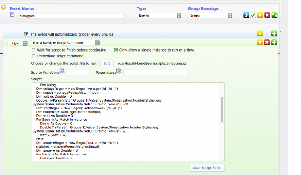

  • 8 måneder senere...
Klipt og limt litt jeg, lagt fire VD som kun har status med id 477,478,479,480, og limt inn følgende i scripetet som jeg har kalt smappee.cs:
Imports System.Text.RegularExpressions
Imports System.Net
Public Sub Main(ByVal parm As Object)
	Using client As New WebClient()
            client.Headers.Add(HttpRequestHeader.ContentType, "application/json")
            client.UploadString("http://gullfrodesIP/gateway/apipublic/logon","POST","admin")
        End Using
	Dim input As String
            input = client.DownloadString("http://gullfrodesIP/gateway/apipublic/reportInstantaneousValues")
        End Using
    Dim voltageRegex = New Regex("voltage=(\d+.\d+)")
    Dim match = voltageRegex.Match(input)
    Dim volt As Double = 0
    Double.TryParse(match.Groups(1).Value, System.Globalization.NumberStyles.Any, System.Globalization.CultureInfo.GetCultureInfo("en-us"), volt)
    Dim wattRegex = New Regex(" activePower=(\d+.\d+)")

Error	Compiling script /usr/local/HomeSeer/scripts/smappee.cs: {interactive}(1,21): error CS1525: Unexpected symbol `As', expecting `,', `;', or `=' {interactive}(11,6): error CS1525: Unexpected symbol `System', expecting `,', `;', or `=' {interactive}(12,6): error CS1525: Unexpected symbol `Scheduler', expecting `,', `;', or `=' {interactive}(13,6): error CS1525: Unexpected symbol `HomeSeerAPI', expecting `,', `;', or `=' {interactive}(14,0): error CS1525: Unexpected symbol `public', expecting `,', `;', or `=' {interactive}(16,2): error CS1525: Unexpected symbol `public', expecting `,', `;', or `=' {interactive}(18,1): error CS1525: Unexpected symbol `}', expecting `,', `;', or `=' {interactive}(37,44): error CS1009: Unrecognized escape sequence `\d' {interactive}(37,48): error CS1009: Unrecognized escape sequence `\d' {interactive}(42,0): error CS0589: Internal compiler error during parsing
Tips mottas med takk!
Det er ikke et C#-script, så det skal ikke ha .cs-filnavn. Det er et VB.net-script, og har følgelig en .vb-ending. :)
HomeSeer prøver å kompilere et VB-script med C#-kompilatoren. Det liker den dårlig. ;)
Det er ikke et C#-script, så det skal ikke ha .cs-filnavn. Det er et VB.net-script, og har følgelig en .vb-ending. [emoji4]
HomeSeer prøver å kompilere et VB-script med C#-kompilatoren. Det liker den dårlig. [emoji6]
Derfor jeg skrev klipp og lim, er en aper, ikke skaper;o).
Tusen takk nok en gang Moskus.
Er som hintet Blanko, får fremdeles feilmelding:
Running script /usr/local/HomeSeer/scripts/Smappee.vb :Exception has been thrown by the target of an invocation.Attempted to access a missing member.
