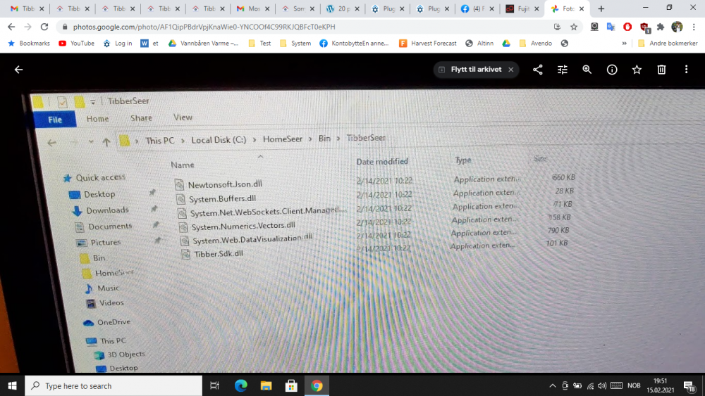

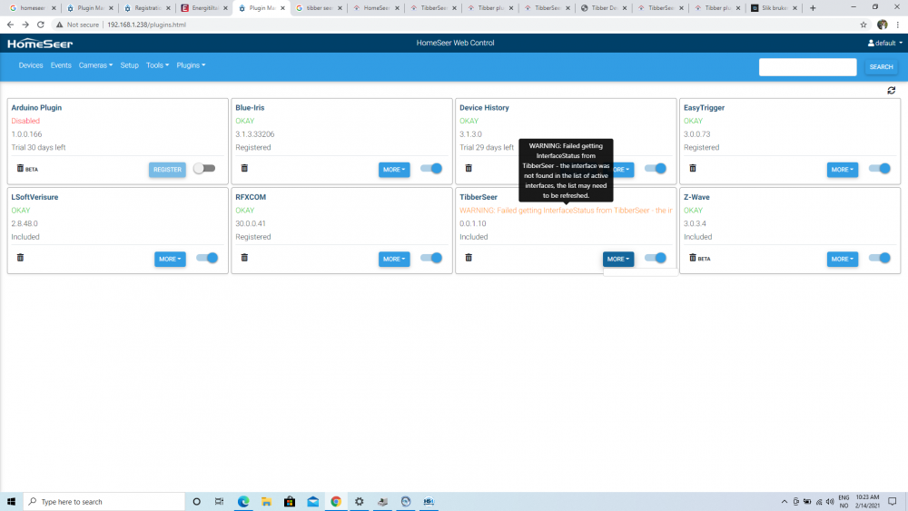

Rune L2 Skrevet 14. februar 2021 Skrevet 14. februar 2021 Får ikke åpnet plugin. Har kopiert filer til Homeseer mappe. Restartet på men fungerer fortsatt ikke. Noe forslag? Siter
Moskus Skrevet 15. februar 2021 Forfatter Skrevet 15. februar 2021 På 14.2.2021 den 10.27, Rune L2 skrev: Noe forslag? Kan du vise hva loggen sier når du starter TibberSeer? På 14.2.2021 den 10.27, Rune L2 skrev: Har kopiert filer til Homeseer mappe. Gjelder det mappene også? Siter
Rune L2 Skrevet 15. februar 2021 Skrevet 15. februar 2021 2/15/2021 12:23:30 Legacy-Plugin RFXCOM 41 (CheckSensors) inp sensor:176 2/15/2021 12:23:21 HomeSeer Plug-In Finished initializing plug-in TibberSeer 2/15/2021 12:23:21 HomeSeer Starting Plug-In TibberSeer loaded in 5211 milliseconds 2/15/2021 12:23:21 HomeSeer Error Initializing plug-in(2): TibberSeer Instance::Disconnected before response received.STACK: at HSCF.Communication.ScsServices.Communication.RequestReplyMessenger`1.SendMessageAndWaitForResponse(IScsMessage message, Int32 timeoutMilliseconds) at HSCF.Communication.ScsServices.Communication.RequestReplyMessenger`1.SendMessageAndWaitForResponse(IScsMessage message) at HSCF.Communication.ScsServices.Communication.RemoteInvokeProxy`2.Invoke(IMessage msg) at System.Runtime.Remoting.Proxies.RealProxy.PrivateInvoke(MessageData& msgData, Int32 type) at HomeSeerAPI.IPlugInAPI.InitIO(String port) at Scheduler.PluginHolder.InitIO(String PortNumber) at Scheduler.clsHSPI.CheckInterfaces() 2/15/2021 12:23:21 HomeSeer Info Plugin TibberSeer with ID: and Instance: has disconnected 2/15/2021 12:23:16 HomeSeer Starting Plug-In Initializing plugin TibberSeer ... 2/15/2021 12:23:16 HomeSeer Info Plugin TibberSeer has connected. IP:127.0.0.1:51833 2/15/2021 12:23:14 Legacy-Plugin RFXCOM Error: 41 (decode_InterfaceMessage) wrong transceiver type selected! 2/15/2021 12:23:14 HomeSeer HSTouch Server Debug 12:23:14:9344 ~ Value change ref:11 Address:X_TRX[1]Q NewVal: 1OldVal: 1 2/15/2021 12:23:14 Legacy-Plugin RFXCOM Error: 41 (decode_InterfaceMessage) transceiver 1 off-line! Siter
Rune L2 Skrevet 15. februar 2021 Skrevet 15. februar 2021 Har kopiert alle filene i undermapper også. Men ser att den ene undermappen har flere filer en det jeg kopierte. Siter
Moskus Skrevet 15. februar 2021 Forfatter Skrevet 15. februar 2021 Hmm! Ja, det var jo ikke særlig hjelpsomt. Kan du sjekke oppgavebehandler/task manager om at HSPI_TibberSeer.exe ikke allerede kjører? 1 time siden, Rune L2 skrev: Men ser att den ene undermappen har flere filer en det jeg kopierte. Øh... jaha? Hvilke filer er det? Siter

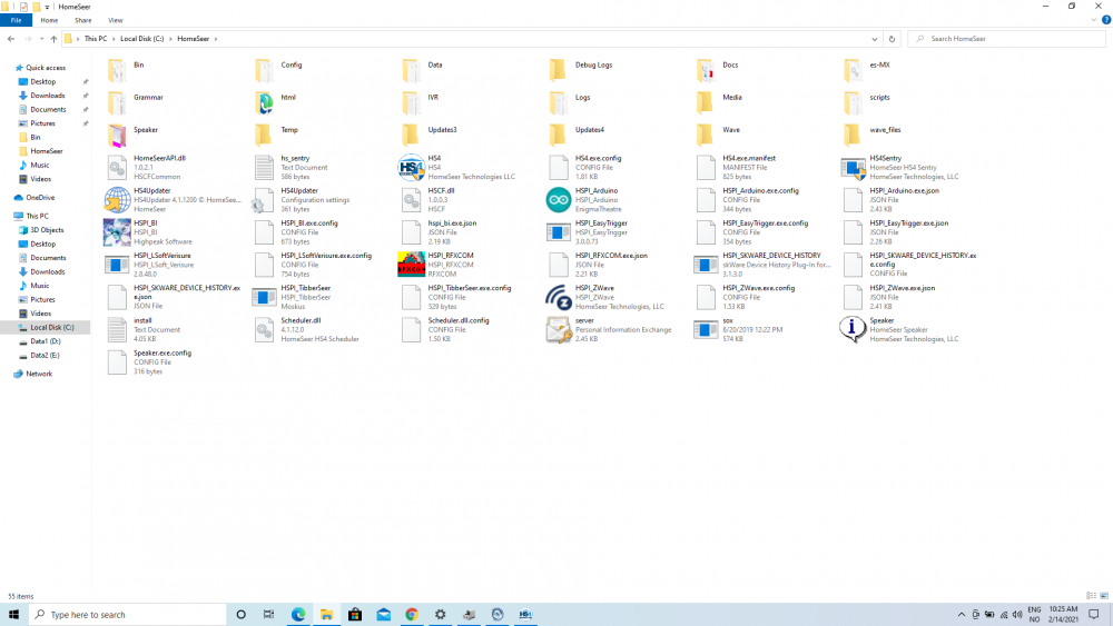

Rune L2 Skrevet 15. februar 2021 Skrevet 15. februar 2021 Disse filene er der oppgavebehandler/task manage Finner ikke HSPI_TibberSeer.exe Men finner mange andre programmer som hører til Homeseer der Siter
Moskus Skrevet 15. februar 2021 Forfatter Skrevet 15. februar 2021 Ser riktig ut, ja. (Tips Windowstast + Shift + S gir snip-verktøy ). Siter
