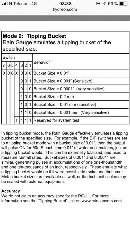

Men:
Sitat
I want to know how much rain has fallen in specific period of time. Will the RG-11 Rain Sensor easily do this for me?
Unfortunately, the RG-11 does not come with a readout, so it will not easily give the amount of rain fall over a time. The Rain Gauge has an output that "pulses" when a certain rain event — set by the specific modes — has occurred. It is up to the purchaser to interpret the data as they see fit.
We have received many calls and inquiries from farmers wanting a simple, maintenance free rain gauge that gives an easy to interpret readout. We have concluded that this is not the product the farmers are looking for. The RG-11, in it’s current form, is mainly for system designers to design into other products. Plus, the RG-11 is not wireless, which seems to be what the farmers really want.
What is the accuracy of the RG-11 Rain Gauge?
The Hydreon Rain Gauge is not as accurate as a properly maintained Tipping Bucket in ideal conditions.
We do not claim an accuracy specification for the RG-11 Rain Gauge.  The RG-11 is very repeatable, and over a variety of conditions will yield an average result that is reasonably close to that of a tipping bucket.  But, for any given rainstorm the result can be off by as much as 2:1 in either direction.   Even this is not an upper limit.
The strength of the RG-11 is that it works in many situations where a tipping bucket simply does not.  That is, the Rain Sensor is vastly more accurate than a tipping bucket that has ceased to work properly due to dirt or mineral deposit or mechanical difficulty, or a tipping bucket in a mobile application that is constantly giving false indications due to motion.  The RG-11 is more accurate for a small (but in some applications, meaningful) amount of rain, such as 0.01", that will simply not register in a tipping bucket.
This said, if you do not need the ruggedness of the Hydreon Rain Gauge, and maintaining the tipping bucket is not a problem, use a tipping bucket.
