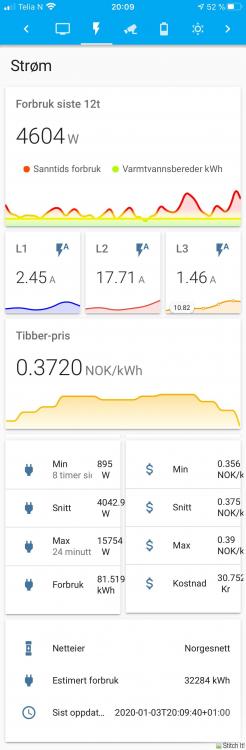

Hei og godt nytt år :)
Er det andre enn meg som mistet accumulatedCost da klokka tippet 00:00 i natt ?
timestamp: '2020-01-01T10:15:40+01:00'
powerProduction: 0
accumulatedProduction: 0
accumulatedConsumption: 24.995953
accumulatedCost: 0
currency: NOK
minPower: 777
averagePower: 2435.8
maxPower: 9218
lastMeterConsumption: 29501.57
lastMeterProduction: 0
voltagePhase1: 233.5
voltagePhase2: 241
voltagePhase3: 234.5
currentPhase1: 6.3
currentPhase2: 2.66
currentPhase3: 2.2
unit_of_measurement: W
cards:
  - cards:
      - color_thresholds:
          - color: '#0FA300'
            value: 0
          - color: '#18FF00'
            value: 1000
          - color: '#F4F700'
            value: 3000
          - color: '#FCBD00'
            value: 4000
          - color: '#FD0000'
            value: 5000
        entities:
          - sensor.real_time_consumption_buskogen_88
          - sensor.varmtvannsbereder_energy
        height: 90
        hour24: true
        hours_to_show: 12
        line_width: 4
        name: Forbruk siste 12t
        points_per_hour: 4
        show:
          icon: false
        type: 'custom:mini-graph-card'
      - cards:
          - entities:
              - sensor.tibber_amp_l1
            font_size: 75
            hour24: true
            hours_to_show: 12
            icon: 'mdi:flash-auto'
            line_color: blue
            line_width: 8
          - entities:
              - sensor.tibber_amp_l2
            font_size: 75
            hour24: true
            hours_to_show: 12
            line_color: '#e74c3c'
            line_width: 8
          - entities:
              - sensor.tibber_amp_l3
            font_size: 75
            hour24: true
            hours_to_show: 12
            line_color: var(--accent-color)
            line_width: 8
        type: horizontal-stack
      - cards:
          - color_thresholds:
              - color: '#0FA300'
                value: '0.00'
              - color: '#18FF00'
                value: '0.30'
              - color: '#F4F700'
                value: '0.35'
              - color: '#FCBD00'
                value: '0.30'
              - color: '#FD9A00'
                value: '0.40'
              - color: '#FD0000'
                value: '0.50'
            decimals: 4
            entities:
              - sensor.electricity_price_buskogen_88
            height: 80
            hour24: true
            hours_to_show: 12
            line_width: 3
            points_per_hour: 4
            show:
              fill: fade
              icon: false
          - cards:
              - entities:
                  - entity: sensor.tibber_minpower
                    secondary_info: last-changed
                  - type: section
                  - entity: sensor.tibber_averagepower
                  - type: section
                  - entity: sensor.tibber_maxpower
                  - type: section
                  - entity: sensor.tibber_accumulatedconsumption
                type: entities
              - entities:
                  - type: section
                  - entity: sensor.tibber_avg
                  - type: section
                  - type: section
                  - entity: sensor.tibber_accumulatedcost
                type: entities
          - entities:
              - entity: sensor.tibber_nett
                icon: 'mdi:fuse'
              - entity: sensor.tibber_estimert
              - entity: sensor.tibber_time
            type: entities
        type: vertical-stack
    layout: vertical
    type: 'custom:layout-card'
icon: 'mdi:flash'
panel: true
path: power
title: Strøm
Endret av Kråkerøymannen

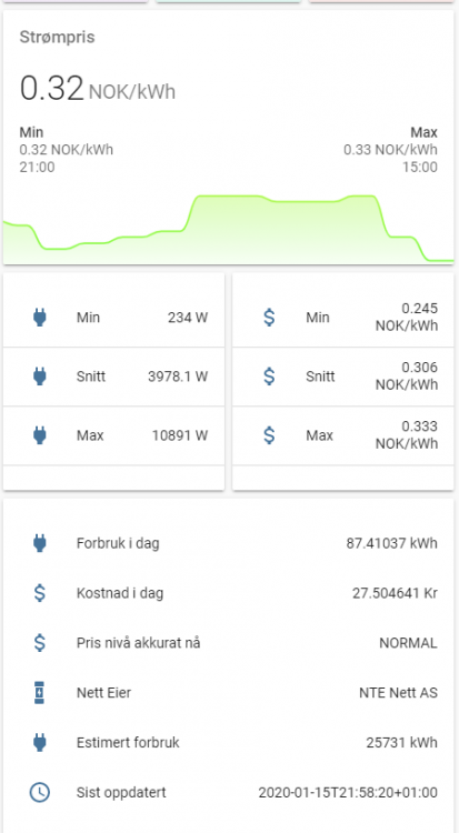

Som en fersk HA bruker, hvordan henter du ut sensor.tibber_accumulatedcost etc
Jeg har bare to som default (sensor.electricity_price og sensor.real_time_consumption)
Er det noe du har laget i config.yaml
Mulig å ta en titt? Begynte med HA i dag, så muligens et teit spørsmål
Kort fortalt: du må definere de som sensorer i sensors.yaml
Først må du peke sensors til Sensors.yalm. Det gjør du i configurations.yaml.
Har dessverre ikke tilgang til egne koder akkurat nå.
Pål Engh
Kråkerøy
Jeg gjort dette i min sensor.yaml(Jeg har pekt senors i configurations.yaml som dette:)
sensor: !include sensor.yaml
Vis du ikke bruker/har egen sensor.yaml så kan du legge inn dette under sensor: i  configurations.yaml
Bytt ut sensor.real_time_consumption_adresse_1234 og sensor.electricity_price_adresse_1234 med de to du har.
  - platform: template
    sensors:
      tibber_nett:
        friendly_name: "Nett Eier"
        value_template: "{{ state_attr('sensor.electricity_price_adresse_1234', 'grid_company') }}"
        icon_template: mdi:fuse
      tibber_max:
        friendly_name: "Max pris"
        unit_of_measurement: "NOK/kWh"
        value_template: "{{ state_attr('sensor.electricity_price_adresse_1234', 'max_price') }}"
        icon_template: mdi:currency-usd
      tibber_avg:
        friendly_name: "Gjennomsnittspris"
        value_template: "{{ state_attr('sensor.electricity_price_adresse_1234', 'avg_price') }}"
      tibber_min:
        friendly_name: "Minimumspris"
        value_template: "{{ state_attr('sensor.electricity_price_adresse_1234', 'min_price') }}"
      tibber_estimert:
        unit_of_measurement: 'kWh'
        friendly_name: "Estimert forbruk"
        value_template: "{{ state_attr('sensor.electricity_price_adresse_1234', 'estimated_annual_consumption') }}"
        icon_template: mdi:power-plug
      tibber_time:
        friendly_name: "Sist oppdatert"
        value_template: "{{ state_attr('sensor.real_time_consumption_adresse_1234', 'timestamp') }}"
        icon_template: mdi:clock-outline
      tibber_minpower:
        friendly_name: "Laveste forbruk"
        unit_of_measurement: "W"
        value_template: "{{ state_attr('sensor.real_time_consumption_adresse_1234', 'minPower') }}"
      tibber_averagepower:
        friendly_name: "Gjennomsnitts forbruk"
        value_template: "{{ state_attr('sensor.real_time_consumption_adresse_1234', 'averagePower') }}"
      tibber_maxpower:
        friendly_name: "Høyeste forbruk"
        value_template: "{{ state_attr('sensor.real_time_consumption_adresse_1234', 'maxPower') }}"
      tibber_accumulatedconsumption:
        friendly_name: "Forbruk i dag"
        value_template: "{{ state_attr('sensor.real_time_consumption_adresse_1234', 'accumulatedConsumption') }}"
      tibber_accumulatedcost:
        friendly_name: "Kostnad i dag"
        unit_of_measurement: 'Kr'
        value_template: "{{ state_attr('sensor.real_time_consumption_adresse_1234', 'accumulatedCost') }}"

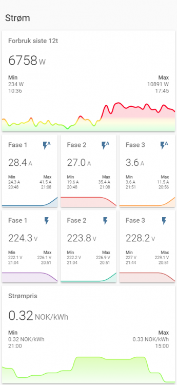

    sensors:
      tibber_nett:
      tibber_max:
      tibber_avg:
      tibber_min:
      tibber_estimert:
      tibber_time:
      tibber_minpower:
      tibber_maxpower:
      tibber_volt:
        friendly_name: "AMS Spenning"
        unit_of_measurement: 'V'
        value_template: "{{ state_attr('sensor.real_time_consumption_adresse_1234', 'voltagePhase1') }}"
        icon_template: mdi:flash
      tibber_amp:
        friendly_name: "AMS Strøm"
        unit_of_measurement: 'A'
        value_template: "{{ state_attr('sensor.real_time_consumption_adresse_1234', 'currentPhase1') }}"
        icon_template: mdi:current-ac
      tibber_meter:
        friendly_name: "Målerstand"
        value_template: "{{ state_attr('sensor.real_time_consumption_adresse_1234', 'lastMeterConsumption') }}"
        icon_template: mdi:counter
      tibber_level:
        friendly_name: "Pris"
        value_template: "{{ state_attr('sensor.electricity_price_adresse_1234', 'price_level') }}"
Takk Offpiste, utrolig nyttig for en som bare har lekt med HA noen dager. Tusen takk!
