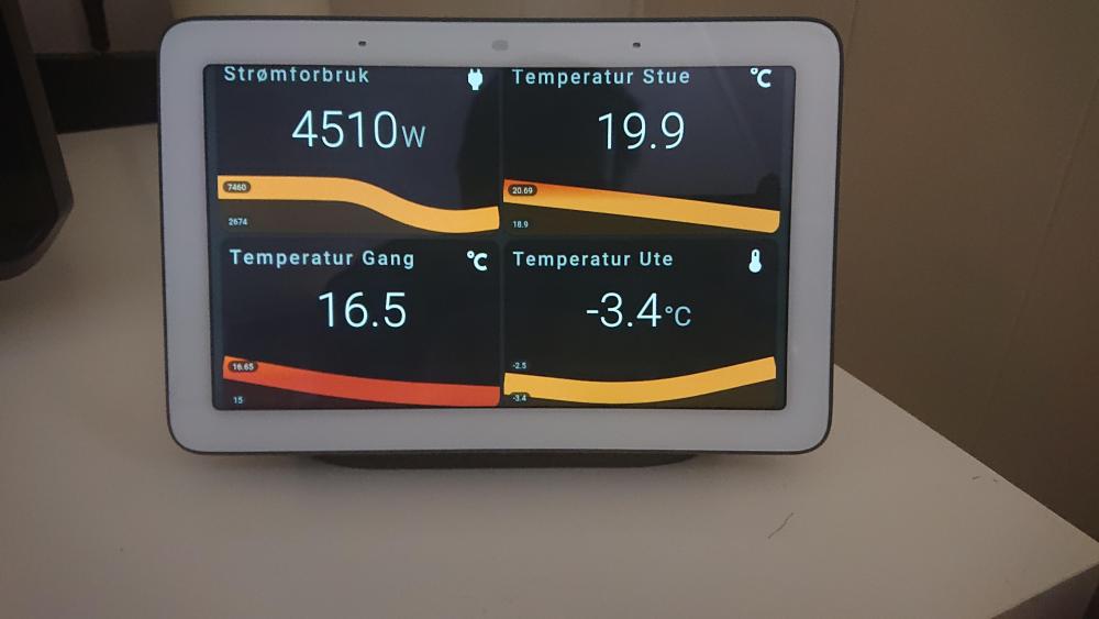

3 timer siden, tomfrode skrev:
Her er integreringen inklusiv tibber sensor, sensibo hub & mill wall switch på nest hubben i huset.
strekene endrer farge/beveger seg etter temperatur og strømforbruk.
yaml koden i lovelace er;
  - panel: false
    path: nest
    title: Nest
    theme: Backend-selected
    badges: []
    cards:
      - type: 'custom:mini-graph-card'
        entities:
          - entity: sensor.real_time_consumption_xxx
            index: 0
        align_state: center
        line_width: 40
        font_size_header: 28
        font_size: 250
        height: 100
        hours_to_show: 168
        aggregate_func: max
        group_by: date
        show:
          graph: line
          labels: true
          color_thresholds:
            - value: 1500
              color: '#f39c12'
            - value: 2500
              color: '#d35400'
            - value: 5000
              color: '#c0392b'
      - align_state: center
        entities:
          - entity: sensor.temperatur_nede
            index: 0
        font_size: 250
        height: 100
        show:
          labels: true
        color_thresholds:
          - value: 17
            color: '#f39c12'
          - value: 16.5
            color: '#d35400'
          - value: 16
            color: '#c0392b'
        line_width: 40
        hours_to_show: 6
        icon: 'mdi:temperature-celsius'
        entities:
          - entity: sensor.temperatur_oppe
            index: 0
        font_size: 250
        height: 100
        show:
          labels: true
        color_thresholds:
          - value: 21
            color: '#c0392b'
          - value: 20.5
            color: '#d35400'
          - value: 20
            color: '#f39c12'
        line_width: 40
        hours_to_show: 6
        entities:
          - entity: sensor.weather_temperature
            index: 0
        font_size: 250
        height: 100
        show:
          labels: true
        color_thresholds:
          - value: 6
            color: '#c0392b'
          - value: 3
            color: '#d35400'
          - value: 0
            color: '#f39c12'
        line_width: 40
        hours_to_show: 6
Endret av tomfrode

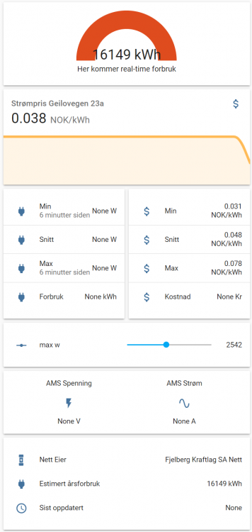

På 9.1.2020 den 23.03, Offpiste skrev:
Jeg gjort dette i min sensor.yaml(Jeg har pekt senors i configurations.yaml som dette:)
sensor: !include sensor.yaml
Vis du ikke bruker/har egen sensor.yaml så kan du legge inn dette under sensor: i  configurations.yaml
Bytt ut sensor.real_time_consumption_adresse_1234 og sensor.electricity_price_adresse_1234 med de to du har.
  - platform: template
    sensors:
      tibber_nett:
        friendly_name: "Nett Eier"
        value_template: "{{ state_attr('sensor.electricity_price_adresse_1234', 'grid_company') }}"
        icon_template: mdi:fuse
      tibber_max:
        friendly_name: "Max pris"
        unit_of_measurement: "NOK/kWh"
        value_template: "{{ state_attr('sensor.electricity_price_adresse_1234', 'max_price') }}"
        icon_template: mdi:currency-usd
      tibber_avg:
        friendly_name: "Gjennomsnittspris"
        value_template: "{{ state_attr('sensor.electricity_price_adresse_1234', 'avg_price') }}"
      tibber_min:
        friendly_name: "Minimumspris"
        value_template: "{{ state_attr('sensor.electricity_price_adresse_1234', 'min_price') }}"
      tibber_estimert:
        unit_of_measurement: 'kWh'
        friendly_name: "Estimert forbruk"
        value_template: "{{ state_attr('sensor.electricity_price_adresse_1234', 'estimated_annual_consumption') }}"
        icon_template: mdi:power-plug
      tibber_time:
        friendly_name: "Sist oppdatert"
        value_template: "{{ state_attr('sensor.real_time_consumption_adresse_1234', 'timestamp') }}"
        icon_template: mdi:clock-outline
      tibber_minpower:
        friendly_name: "Laveste forbruk"
        unit_of_measurement: "W"
        value_template: "{{ state_attr('sensor.real_time_consumption_adresse_1234', 'minPower') }}"
      tibber_averagepower:
        friendly_name: "Gjennomsnitts forbruk"
        value_template: "{{ state_attr('sensor.real_time_consumption_adresse_1234', 'averagePower') }}"
      tibber_maxpower:
        friendly_name: "Høyeste forbruk"
        value_template: "{{ state_attr('sensor.real_time_consumption_adresse_1234', 'maxPower') }}"
      tibber_accumulatedconsumption:
        friendly_name: "Forbruk i dag"
        value_template: "{{ state_attr('sensor.real_time_consumption_adresse_1234', 'accumulatedConsumption') }}"
      tibber_accumulatedcost:
        friendly_name: "Kostnad i dag"
        unit_of_measurement: 'Kr'
        value_template: "{{ state_attr('sensor.real_time_consumption_adresse_1234', 'accumulatedCost') }}"
      tibber_volt:
        friendly_name: "AMS Spenning"
        unit_of_measurement: 'V'
        value_template: "{{ state_attr('sensor.real_time_consumption_adresse_1234', 'voltagePhase1') }}"
        icon_template: mdi:flash
      tibber_amp:
        friendly_name: "AMS Strøm"
        unit_of_measurement: 'A'
        value_template: "{{ state_attr('sensor.real_time_consumption_adresse_1234', 'currentPhase1') }}"
        icon_template: mdi:current-ac
      tibber_meter:
        friendly_name: "Målerstand"
        value_template: "{{ state_attr('sensor.real_time_consumption_adresse_1234', 'lastMeterConsumption') }}"
        icon_template: mdi:counter
      tibber_level:
        friendly_name: "Pris"
        value_template: "{{ state_attr('sensor.electricity_price_adresse_1234', 'price_level') }}"
Må man ha Tibber Pulse for å få inn alle disse sensorene?

3. Ved beregning av kostnader det bare å summere input_number.nettleie og sensor.electricity_price_adresse før du multipliserer med forbruk. Jeg bruker dette selv feks i notifikasjonen om at vaskemaskin er ferdig (inkludert kost) og totalkost/time for alt strøm.
Da tar jeg sjansen på å vise hva jeg har. Alt sammen (bortsett fra en liten detalj) er data som kommer i fra Tibber komponenten. Forbruk pr dag, måned og år kommer ikke fra Utility komponenten til HA. Fant ut den ikke telte kilowattimer like nøyaktig som måleren i skapet. Dessuten har den skifte til ny dag nøyaktig ved midnatt, mens Tibber komponenten gjerne kan levere data noen sekunder etter midnatt. Da havnet noe av forbruket på feil døgn i utility komponenten.
