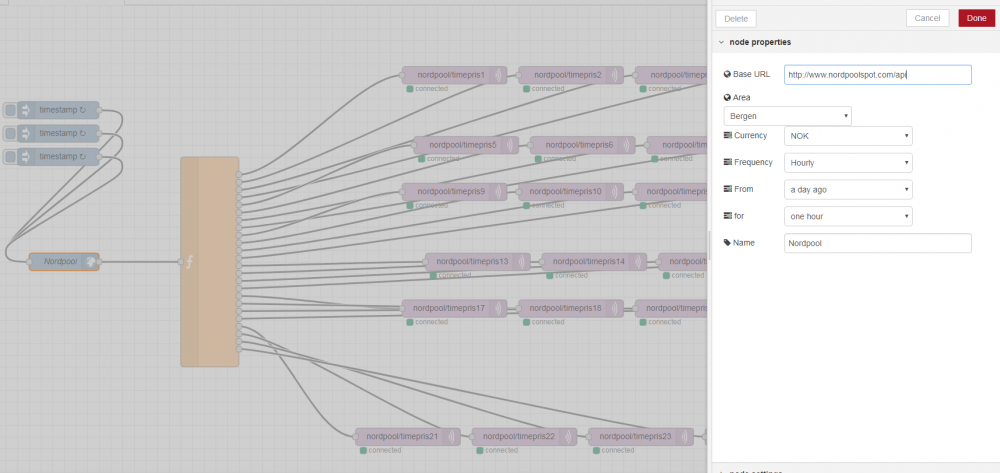

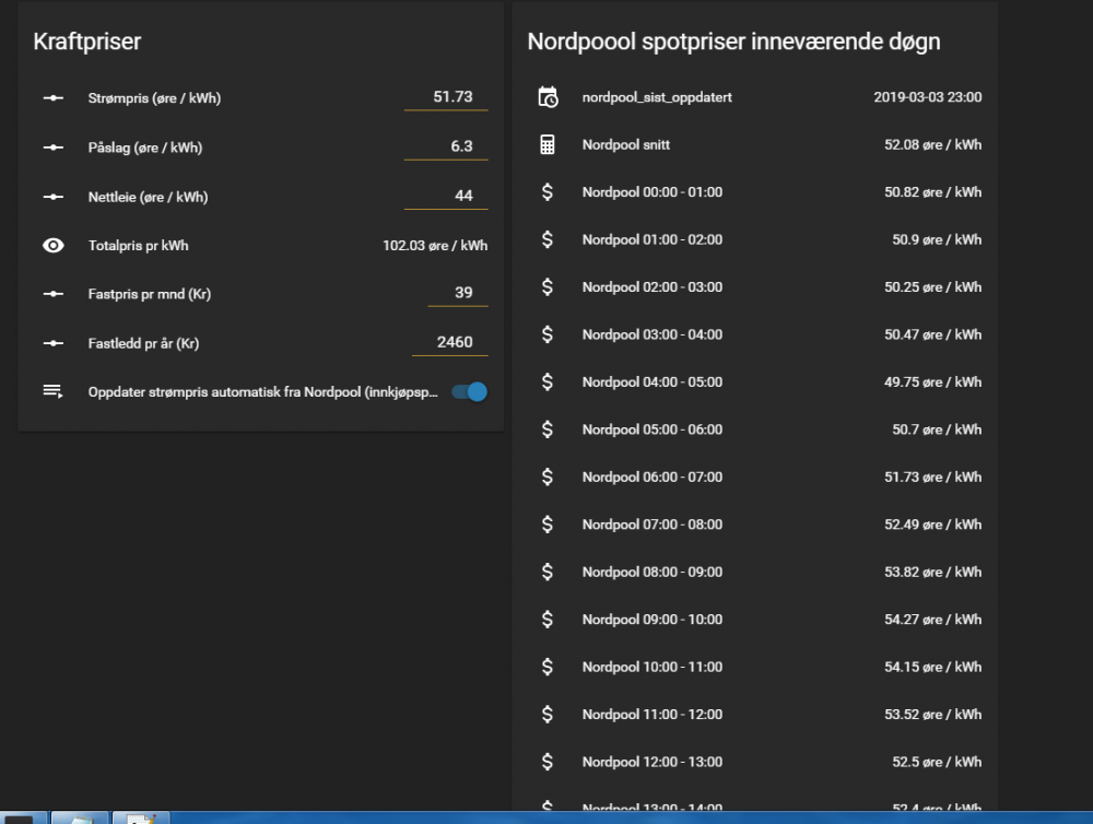

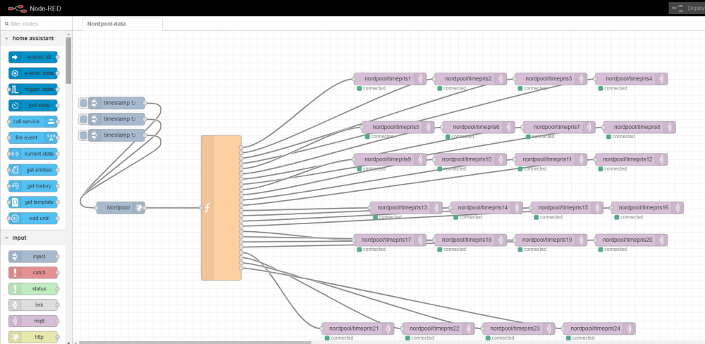

Er selv litt i FOU for tiden men har funnet en fantastisk pallette til Node Red som fikser daglig oppdatering av spottpriser fra Nordpool. Dette gir meg full oversikt over dagens priser og kan med litt automasjon oppdatere hva du betaler for energibruken time for time. I tillegg ved å bruke en Min / Max sensor kan du få eksakt snittpris for dagen. En god erstatting for Tibber å den er i tillegg gratis.
Endret av Hassi
Kunne du tenke deg å dele denne Node Red Sekvensen?
[{"id":"e2e4fe1d.7c595","type":"tab","label":"Nordpool-data","disabled":false,"info":""},{"id":"aeee093.bf433f8","type":"nordpool","z":"e2e4fe1d.7c595","baseUrl":"http://www.nordpoolspot.com/api","area":"Bergen","currency":"NOK","page":"10","start":"P1D","duration":"PT1H","name":"Nordpool","x":120,"y":440,"wires":[["83998c36.5f1e"]]},{"id":"83998c36.5f1e","type":"function","z":"e2e4fe1d.7c595","name":"","func":"var msg24 = msg.payload.map(function (p) {\n    return {payload: p};\n});\nreturn msg24;","outputs":24,"noerr":0,"x":370,"y":440,"wires":[["725c4f1d.8fd22"],["94fda574.976d48"],["41d0ac4a.b03bc4"],["3a190524.5a2bda"],["15dd54db.94427b"],["2d36f6dd.805bca"],["5a13129c.9b921c"],["1672f088.3bfe7f"],["f8199855.d51778"],["ea5de329.d15cb"],["34434fb0.6f35b"],["4fb8e53b.51fb5c"],["dd1b0791.e89778"],["1bcfdddc.502802"],["136ee9ac.613226"],["b721cf7f.4adce"],["1740d567.08029b"],["1ce40579.edba9b"],["876cc91a.08ccd8"],["abe06a61.25f758"],["271c8a17.f96176"],["5284e3bd.9e068c"],["c3dee96c.c99548"],["458b73aa.5cd84c"]]},{"id":"725c4f1d.8fd22","type":"mqtt out","z":"e2e4fe1d.7c595","name":"","topic":"nordpool/timepris1","qos":"","retain":"true","broker":"c50624a.016f3d8","x":790,"y":120,"wires":[]},{"id":"94fda574.976d48","type":"mqtt out","z":"e2e4fe1d.7c595","name":"","topic":"nordpool/timepris2","qos":"","retain":"true","broker":"c50624a.016f3d8","x":990,"y":120,"wires":[]},{"id":"41d0ac4a.b03bc4","type":"mqtt out","z":"e2e4fe1d.7c595","name":"","topic":"nordpool/timepris3","qos":"","retain":"true","broker":"c50624a.016f3d8","x":1190,"y":120,"wires":[]},{"id":"3a190524.5a2bda","type":"mqtt out","z":"e2e4fe1d.7c595","name":"","topic":"nordpool/timepris4","qos":"","retain":"true","broker":"c50624a.016f3d8","x":1390,"y":120,"wires":[]},{"id":"15dd54db.94427b","type":"mqtt out","z":"e2e4fe1d.7c595","name":"","topic":"nordpool/timepris5","qos":"","retain":"true","broker":"c50624a.016f3d8","x":810,"y":240,"wires":[]},{"id":"2d36f6dd.805bca","type":"mqtt out","z":"e2e4fe1d.7c595","name":"","topic":"nordpool/timepris6","qos":"","retain":"true","broker":"c50624a.016f3d8","x":1010,"y":240,"wires":[]},{"id":"5a13129c.9b921c","type":"mqtt out","z":"e2e4fe1d.7c595","name":"","topic":"nordpool/timepris7","qos":"","retain":"true","broker":"c50624a.016f3d8","x":1210,"y":240,"wires":[]},{"id":"1672f088.3bfe7f","type":"mqtt out","z":"e2e4fe1d.7c595","name":"","topic":"nordpool/timepris8","qos":"","retain":"true","broker":"c50624a.016f3d8","x":1410,"y":240,"wires":[]},{"id":"f8199855.d51778","type":"mqtt out","z":"e2e4fe1d.7c595","name":"","topic":"nordpool/timepris9","qos":"","retain":"true","broker":"c50624a.016f3d8","x":790,"y":320,"wires":[]},{"id":"ea5de329.d15cb","type":"mqtt out","z":"e2e4fe1d.7c595","name":"","topic":"nordpool/timepris10","qos":"","retain":"true","broker":"c50624a.016f3d8","x":990,"y":320,"wires":[]},{"id":"34434fb0.6f35b","type":"mqtt out","z":"e2e4fe1d.7c595","name":"","topic":"nordpool/timepris11","qos":"","retain":"true","broker":"c50624a.016f3d8","x":1190,"y":320,"wires":[]},{"id":"4fb8e53b.51fb5c","type":"mqtt out","z":"e2e4fe1d.7c595","name":"","topic":"nordpool/timepris12","qos":"","retain":"true","broker":"c50624a.016f3d8","x":1390,"y":320,"wires":[]},{"id":"dd1b0791.e89778","type":"mqtt out","z":"e2e4fe1d.7c595","name":"","topic":"nordpool/timepris13","qos":"","retain":"true","broker":"c50624a.016f3d8","x":830,"y":440,"wires":[]},{"id":"1bcfdddc.502802","type":"mqtt out","z":"e2e4fe1d.7c595","name":"","topic":"nordpool/timepris14","qos":"","retain":"true","broker":"c50624a.016f3d8","x":1030,"y":440,"wires":[]},{"id":"136ee9ac.613226","type":"mqtt out","z":"e2e4fe1d.7c595","name":"","topic":"nordpool/timepris15","qos":"","retain":"true","broker":"c50624a.016f3d8","x":1230,"y":440,"wires":[]},{"id":"b721cf7f.4adce","type":"mqtt out","z":"e2e4fe1d.7c595","name":"","topic":"nordpool/timepris16","qos":"","retain":"true","broker":"c50624a.016f3d8","x":1430,"y":440,"wires":[]},{"id":"1740d567.08029b","type":"mqtt out","z":"e2e4fe1d.7c595","name":"","topic":"nordpool/timepris17","qos":"","retain":"true","broker":"c50624a.016f3d8","x":790,"y":520,"wires":[]},{"id":"1ce40579.edba9b","type":"mqtt out","z":"e2e4fe1d.7c595","name":"","topic":"nordpool/timepris18","qos":"","retain":"true","broker":"c50624a.016f3d8","x":990,"y":520,"wires":[]},{"id":"876cc91a.08ccd8","type":"mqtt out","z":"e2e4fe1d.7c595","name":"","topic":"nordpool/timepris19","qos":"","retain":"true","broker":"c50624a.016f3d8","x":1190,"y":520,"wires":[]},{"id":"abe06a61.25f758","type":"mqtt out","z":"e2e4fe1d.7c595","name":"","topic":"nordpool/timepris20","qos":"","retain":"true","broker":"c50624a.016f3d8","x":1390,"y":520,"wires":[]},{"id":"271c8a17.f96176","type":"mqtt out","z":"e2e4fe1d.7c595","name":"","topic":"nordpool/timepris21","qos":"","retain":"true","broker":"c50624a.016f3d8","x":710,"y":740,"wires":[]},{"id":"5284e3bd.9e068c","type":"mqtt out","z":"e2e4fe1d.7c595","name":"","topic":"nordpool/timepris22","qos":"","retain":"true","broker":"c50624a.016f3d8","x":910,"y":740,"wires":[]},{"id":"c3dee96c.c99548","type":"mqtt out","z":"e2e4fe1d.7c595","name":"","topic":"nordpool/timepris23","qos":"","retain":"true","broker":"c50624a.016f3d8","x":1110,"y":740,"wires":[]},{"id":"458b73aa.5cd84c","type":"mqtt out","z":"e2e4fe1d.7c595","name":"","topic":"nordpool/timepris24","qos":"","retain":"true","broker":"c50624a.016f3d8","x":1310,"y":740,"wires":[]},{"id":"f64d1e2f.118ec","type":"inject","z":"e2e4fe1d.7c595","name":"","topic":"","payload":"","payloadType":"date","repeat":"","crontab":"59 23 * * *","once":false,"onceDelay":0.1,"x":110,"y":180,"wires":[["aeee093.bf433f8"]]},{"id":"60846d89.6a04b4","type":"inject","z":"e2e4fe1d.7c595","name":"","topic":"","payload":"","payloadType":"date","repeat":"","crontab":"00 00 * * *","once":false,"onceDelay":0.1,"x":110,"y":220,"wires":[["aeee093.bf433f8"]]},{"id":"58a64689.d146f8","type":"inject","z":"e2e4fe1d.7c595","name":"","topic":"","payload":"","payloadType":"date","repeat":"","crontab":"01 00 * * *","once":false,"onceDelay":0.1,"x":110,"y":260,"wires":[["aeee093.bf433f8"]]},{"id":"c50624a.016f3d8","type":"mqtt-broker","z":"","name":"","broker":"localhost","port":"1883","clientid":"","usetls":false,"compatmode":true,"keepalive":"60","cleansession":true,"birthTopic":"","birthQos":"0","birthPayload":"","closeTopic":"","closeQos":"0","closePayload":"","willTopic":"","willQos":"0","willPayload":""}]
