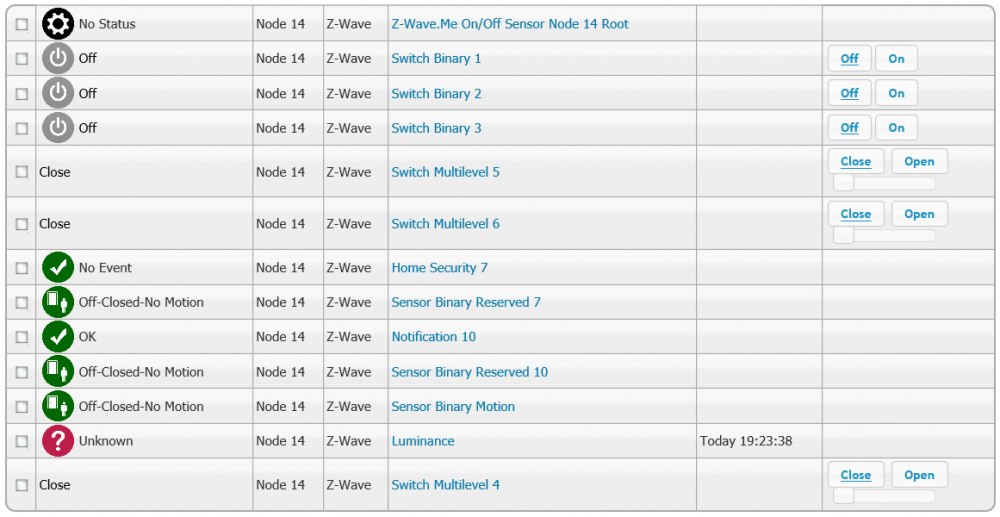

Den kan opprette opptil 10 kanaler, -som blir subdevicer i HomeSeer:
(Men hvor ble nr 8 av ? -Vel den er fremdeles i test )
zuno1.thumb.PNG.2ff2bbd3a21af717d9b8cda6
Her er fra inkluderingen i HomeSeer:
Add Node started...
Activate the 'Add to Network' (Send NodeInfo) function on the node...
A new node has been found and is being added...
Adding a new SLAVE NODE...
DONE - Add Node Operation is Complete.
Done. Node 14 Added.
Reloading (importing) node information...
Synchronizing node information with HomeSeer and creating new device(s) as necessary...
Synchronize nodes finished. Number of device nodes to be created/added = 1
Z-Wave manufacturer information for node 14, ID: 277=115H (Z-Wave.Me), Type: 272=110H, ID: 1=1H
Negotiating or Verifying SECURITY SCHEME for node 14
Z-Wave Security Scheme and Key Exchange was successful for node 14, now waiting for the device to finish storing information before proceeding...
Getting SECURITY class information for node 14
Node: 14 Supports Class(es): ZWAVEPLUS_INFO_V2, BASIC, SWITCH_BINARY, SWITCH_MULTILEVEL_V2, SENSOR_BINARY_V2, ALARM_V2, SENSOR_MULTILEVEL_V2, CONFIGURATION, ASSOCIATION, MULTI_INSTANCE_ASSOCIATION, MULTI_CHANNEL_V2, FIRMWARE_UPDATE_MD, DEVICE_RESET_LOCALLY, ASSOCIATION_GRP_INFO, POWERLEVEL, SECURITY, VERSION_V2, MANUFACTURER_SPECIFIC
Node: 14 Supports Secure Class(es): ZWAVEPLUS_INFO_V2, BASIC, SWITCH_BINARY, SWITCH_MULTILEVEL_V2, SENSOR_BINARY_V2, ALARM_V2, SENSOR_MULTILEVEL_V2, CONFIGURATION, MULTI_INSTANCE_ASSOCIATION, ASSOCIATION_GRP_INFO, ASSOCIATION, VERSION_V2, MANUFACTURER_SPECIFIC, MULTI_CHANNEL_V2
Node 14 is Z-Wave version: Lib: 4,05 App: 0
Node 14 is a Z-Wave Plus node. Retrieving ZWPlus Info...
All associations for node 14 have been retrieved successfully, it supports associations on these groups: 1.
Getting Z-Wave Plus Association Group Information (1 groups) from Node 14...
Node 14 is a V2 Binary Sensor. Supported Sensors: Motion
Error: Failed to get the supported scale for sensor type Luminance of new child device for node 14. Error C
Root Node Device Node 14 Z-Wave Z-Wave.Me On/Off Sensor Node 14 was created for node 14 on network CAF8943A
Test UZB: Adding association for Z-Wave device Node 14 Z-Wave Z-Wave.Me On/Off Sensor Node 14 (Node 14, Group 1, Endpoint 1) to HomeSeer
12 out of 12 Child devices of node 14 were created successfully.
Finished.
