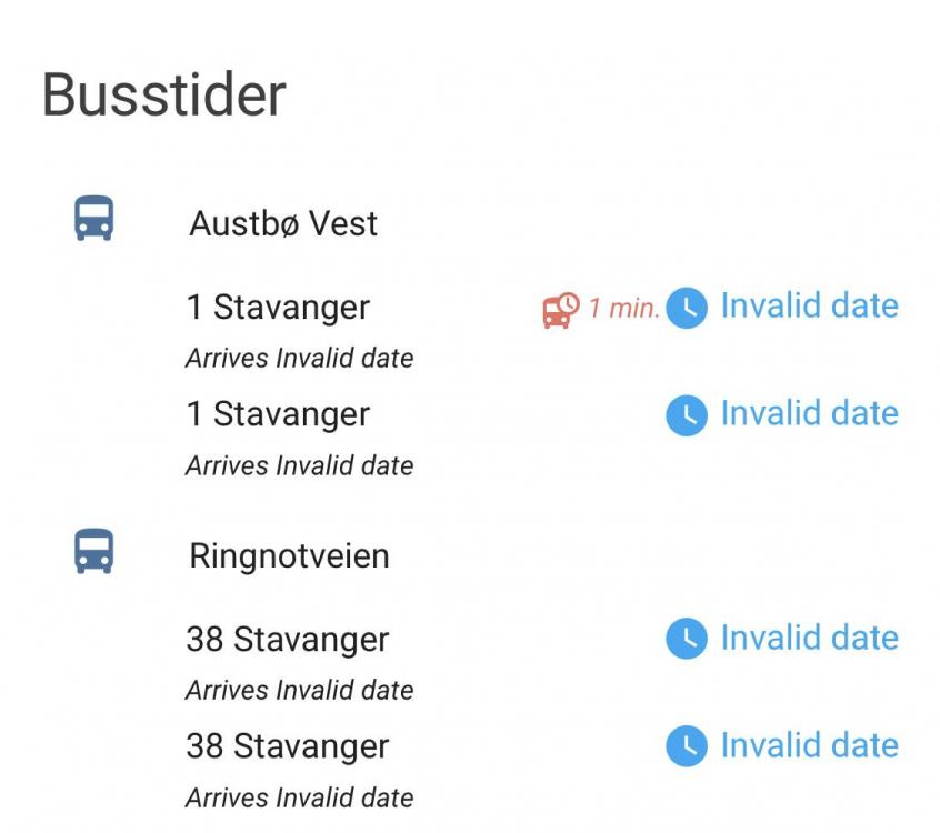

Noen andre enn meg som har lignende problemer etter oppgradering til 0.90 eller 0.91? Mener jeg så en plass at det var gjort noe med datetime i en av de siste release men finner ikke igjen det i farten.
  2jan skrev (På 11.4.2019 den 8.35):
Ekspander
Står i breaking changes: https://www.home-assistant.io/blog/2019/04/03/release-91/#breaking-changes
  Sitat
Public Transit (GTFS)
  • The state for this sensor component was a countdown in minutes. If the next departure was in a few hours, this number became quite large and a tad harder to rapidly calculate mentally (463 minutes anyone?). The sensor’s state output has been changed from minutes to an ISO 8601 UTC timestamp, which allows the UI to interpret the state as needed.
Ekspander
