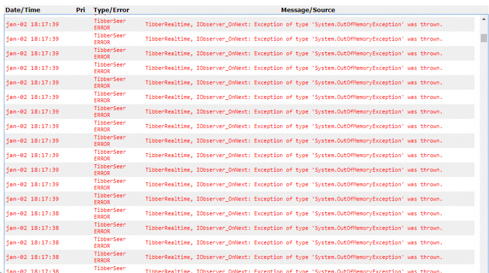

bjornepappa Skrevet 2. januar 2019 Skrevet 2. januar 2019 (endret) Dette ligg i HS-loggen, kl. 2203 var når eg oppdaga det og avslutta TibberSeer i Windows. Deretter starta plugin opp igjen automatisk og ting har fungert som det skal. Som sagt kom det eit meldingsras med events som hadde stoppa opp, dette kom like etter restart av plugin. Jan-01 22:03:14 Starting Plug-In Plugin TibberSeer started successfully in 2217 milliseconds Jan-01 22:03:12 Starting Plug-In Initializing plugin TibberSeer ... Jan-01 22:03:12 Info Plugin TibberSeer has connected. IP:127.0.0.1:56912 Jan-01 22:03:09 Info Plugin TibberSeer with instance: has disconnected Jan-01 22:03:09 Warning I/O interface TibberSeer is down, executable is not running, restarting ... Jan-01 21:15:34 Warning Plugin TibberSeer is not responding but it is still running, not restarting yet. Jan-01 18:35:13 Warning Plugin TibberSeer is not responding but it is still running, not restarting yet. Jan-01 18:27:12 Warning Plugin TibberSeer is not responding but it is still running, not restarting yet. Jan-01 18:19:12 Warning Plugin TibberSeer is not responding but it is still running, not restarting yet. Jan-01 18:11:12 Warning Plugin TibberSeer is not responding but it is still running, not restarting yet. Jan-01 18:03:12 Warning Plugin TibberSeer is not responding but it is still running, not restarting yet. Jan-01 17:55:11 Warning Plugin TibberSeer is not responding but it is still running, not restarting yet. Jan-01 17:47:11 Warning Plugin TibberSeer is not responding but it is still running, not restarting yet. Jan-01 17:39:11 Warning Plugin TibberSeer is not responding but it is still running, not restarting yet. Jan-01 17:31:11 Warning Plugin TibberSeer is not responding but it is still running, not restarting yet. Jan-01 17:23:11 Warning Plugin TibberSeer is not responding but it is still running, not restarting yet. Jan-01 17:15:10 Warning Plugin TibberSeer is not responding but it is still running, not restarting yet. Har no aktivert Debug Logging i TibberSeer, kan det gi fleire hint om det skjer igjen? Event Viewer, er det eit program som då bør installerast på HS-serveren? Edit: Debug Logging gir allerede ganske mange meldingar. Gir dette meining? Date/Time Pri Type/Error Message/Source Jan-02 09:59:21 TibberSeer Debug RestartRealtime done! Jan-02 09:59:21 TibberSeer Debug TibberRealtime new, root: 740 Jan-02 09:59:21 TibberSeer Debug RestartRealtime triggered... Jan-02 09:59:16 TibberSeer Debug Live measurement stream has been terminated. Jan-02 09:59:16 TibberSeer Debug IObserver OnError: Den eksterne enheten avsluttet WebSocket-tilkoblingen uten å fullføre lukkeprosedyren. Jan-02 09:58:16 TibberSeer Debug RestartRealtime done! Jan-02 09:58:16 TibberSeer Debug TibberRealtime new, root: 740 Jan-02 09:58:16 TibberSeer Debug RestartRealtime triggered... Jan-02 09:58:11 TibberSeer Debug IObserver OnError: Den eksterne enheten avsluttet WebSocket-tilkoblingen uten å fullføre lukkeprosedyren. Jan-02 09:58:11 TibberSeer Debug Live measurement stream has been terminated. Jan-02 09:58:06 TibberSeer Debug GetNthLowestPrice for n = '18': 0.6953 Jan-02 09:57:11 TibberSeer Debug RestartRealtime done! Jan-02 09:57:11 TibberSeer Debug TibberRealtime new, root: 740 Jan-02 09:57:11 TibberSeer Debug RestartRealtime triggered... Jan-02 09:57:06 TibberSeer Debug IObserver OnError: Den eksterne enheten avsluttet WebSocket-tilkoblingen uten å fullføre lukkeprosedyren. Jan-02 09:57:06 TibberSeer Debug Live measurement stream has been terminated. Jan-02 09:56:06 TibberSeer Debug RestartRealtime done! Jan-02 09:56:06 TibberSeer Debug TibberRealtime new, root: 740 Jan-02 09:56:06 TibberSeer Debug RestartRealtime triggered... Jan-02 09:56:01 TibberSeer Debug IObserver OnError: Den eksterne enheten avsluttet WebSocket-tilkoblingen uten å fullføre lukkeprosedyren. Jan-02 09:56:01 TibberSeer Debug Live measurement stream has been terminated. Jan-02 09:55:01 TibberSeer Debug RestartRealtime done! Jan-02 09:55:01 TibberSeer Debug TibberRealtime new, root: 740 Jan-02 09:55:01 TibberSeer Debug RestartRealtime triggered... Jan-02 09:54:56 TibberSeer Debug Live measurement stream has been terminated. Jan-02 09:54:56 TibberSeer Debug IObserver OnError: Den eksterne enheten avsluttet WebSocket-tilkoblingen uten å fullføre lukkeprosedyren. Jan-02 09:54:06 TibberSeer Debug GetNthLowestPrice for n = '18': 0.6953 Jan-02 09:53:56 TibberSeer Debug TibberRealtime new, root: 740 Jan-02 09:53:56 TibberSeer Debug RestartRealtime done! Jan-02 09:53:56 TibberSeer Debug RestartRealtime triggered... Jan-02 09:53:51 TibberSeer Debug Live measurement stream has been terminated. Jan-02 09:53:51 TibberSeer Debug IObserver OnError: Den eksterne enheten avsluttet WebSocket-tilkoblingen uten å fullføre lukkeprosedyren. Jan-02 09:52:51 TibberSeer Debug RestartRealtime done! Jan-02 09:52:51 TibberSeer Debug TibberRealtime new, root: 740 Jan-02 09:52:51 TibberSeer Debug RestartRealtime triggered... Jan-02 09:52:46 TibberSeer Debug Live measurement stream has been terminated. Jan-02 09:52:46 TibberSeer Debug IObserver OnError: Den eksterne enheten avsluttet WebSocket-tilkoblingen uten å fullføre lukkeprosedyren. Jan-02 09:51:46 TibberSeer Debug RestartRealtime done! Jan-02 09:51:46 TibberSeer Debug TibberRealtime new, root: 740 Jan-02 09:51:46 TibberSeer Debug RestartRealtime triggered... Jan-02 09:51:41 TibberSeer Debug Live measurement stream has been terminated. Jan-02 09:51:41 TibberSeer Debug IObserver OnError: Den eksterne enheten avsluttet WebSocket-tilkoblingen uten å fullføre lukkeprosedyren. Jan-02 09:50:41 TibberSeer Debug RestartRealtime done! Jan-02 09:50:41 TibberSeer Debug TibberRealtime new, root: 740 Jan-02 09:50:41 TibberSeer Debug RestartRealtime triggered... Jan-02 09:50:36 TibberSeer Debug IObserver OnError: Den eksterne enheten avsluttet WebSocket-tilkoblingen uten å fullføre lukkeprosedyren. Jan-02 09:50:36 TibberSeer Debug Live measurement stream has been terminated. Jan-02 09:50:06 TibberSeer Debug GetNthLowestPrice for n = '18': 0.6953 Jan-02 09:49:36 TibberSeer Debug RestartRealtime done! Jan-02 09:49:36 TibberSeer Debug TibberRealtime new, root: 740 Jan-02 09:49:36 TibberSeer Debug RestartRealtime triggered... Jan-02 09:49:31 TibberSeer Debug Live measurement stream has been terminated. Jan-02 09:49:31 TibberSeer Debug IObserver OnError: Den eksterne enheten avsluttet WebSocket-tilkoblingen uten å fullføre lukkeprosedyren. Jan-02 09:48:31 TibberSeer Debug RestartRealtime done! Jan-02 09:48:31 TibberSeer Debug TibberRealtime new, root: 740 Jan-02 09:48:31 TibberSeer Debug RestartRealtime triggered... Jan-02 09:48:26 TibberSeer Debug Live measurement stream has been terminated. Jan-02 09:48:26 TibberSeer Debug IObserver OnError: Den eksterne enheten avsluttet WebSocket-tilkoblingen uten å fullføre lukkeprosedyren. Jan-02 09:47:26 TibberSeer Debug RestartRealtime done! Jan-02 09:47:26 TibberSeer Debug TibberRealtime new, root: 740 Jan-02 09:47:26 TibberSeer Debug RestartRealtime triggered... Jan-02 09:47:21 TibberSeer Debug Live measurement stream has been terminated. Jan-02 09:47:21 TibberSeer Debug IObserver OnError: Den eksterne enheten avsluttet WebSocket-tilkoblingen uten å fullføre lukkeprosedyren. Jan-02 09:46:21 TibberSeer Debug RestartRealtime done! Jan-02 09:46:21 TibberSeer Debug TibberRealtime new, root: 740 Jan-02 09:46:21 TibberSeer Debug RestartRealtime triggered... Jan-02 09:46:16 TibberSeer Debug IObserver OnError: Den eksterne enheten avsluttet WebSocket-tilkoblingen uten å fullføre lukkeprosedyren. Jan-02 09:46:16 TibberSeer Debug Live measurement stream has been terminated. Jan-02 09:46:06 TibberSeer Debug GetNthLowestPrice for n = '18': 0.6953 Jan-02 09:45:16 TibberSeer Debug TibberRealtime new, root: 740 Jan-02 09:45:16 TibberSeer Debug RestartRealtime done! Jan-02 09:45:16 TibberSeer Debug RestartRealtime triggered... Jan-02 09:45:11 TibberSeer Debug Live measurement stream has been terminated. Jan-02 09:45:11 TibberSeer Debug IObserver OnError: Den eksterne enheten avsluttet WebSocket-tilkoblingen uten å fullføre lukkeprosedyren. Jan-02 09:44:11 TibberSeer Debug RestartRealtime done! Jan-02 09:44:11 TibberSeer Debug TibberRealtime new, root: 740 Jan-02 09:44:11 TibberSeer Debug RestartRealtime triggered... Jan-02 09:44:06 TibberSeer Debug Live measurement stream has been terminated. Jan-02 09:44:06 TibberSeer Debug IObserver OnError: Den eksterne enheten avsluttet WebSocket-tilkoblingen uten å fullføre lukkeprosedyren. Edit 2: Og ved valg TibberSeer ERROR vart det enda meir, dette begynte etter at eg forsøkte å deaktiverte "Keep Realtime Alive". Date/Time Pri Type/Error Message/Source Jan-02 10:57:52 TibberSeer ERROR IObserver OnError: Den eksterne enheten avsluttet WebSocket-tilkoblingen uten å fullføre lukkeprosedyren. Jan-02 10:56:47 TibberSeer ERROR IObserver OnError: Den eksterne enheten avsluttet WebSocket-tilkoblingen uten å fullføre lukkeprosedyren. Jan-02 10:55:42 TibberSeer ERROR IObserver OnError: Den eksterne enheten avsluttet WebSocket-tilkoblingen uten å fullføre lukkeprosedyren. Jan-02 10:54:37 TibberSeer ERROR IObserver OnError: Den eksterne enheten avsluttet WebSocket-tilkoblingen uten å fullføre lukkeprosedyren. Jan-02 10:53:32 TibberSeer ERROR IObserver OnError: Den eksterne enheten avsluttet WebSocket-tilkoblingen uten å fullføre lukkeprosedyren. Jan-02 10:52:27 TibberSeer ERROR IObserver OnError: Den eksterne enheten avsluttet WebSocket-tilkoblingen uten å fullføre lukkeprosedyren. Jan-02 10:51:22 TibberSeer ERROR IObserver OnError: Den eksterne enheten avsluttet WebSocket-tilkoblingen uten å fullføre lukkeprosedyren. Jan-02 10:50:17 TibberSeer ERROR IObserver OnError: Den eksterne enheten avsluttet WebSocket-tilkoblingen uten å fullføre lukkeprosedyren. Jan-02 10:49:12 TibberSeer ERROR IObserver OnError: Den eksterne enheten avsluttet WebSocket-tilkoblingen uten å fullføre lukkeprosedyren. Jan-02 10:48:07 TibberSeer ERROR IObserver OnError: Den eksterne enheten avsluttet WebSocket-tilkoblingen uten å fullføre lukkeprosedyren. Jan-02 10:47:02 TibberSeer ERROR IObserver OnError: Den eksterne enheten avsluttet WebSocket-tilkoblingen uten å fullføre lukkeprosedyren. Jan-02 10:45:57 TibberSeer ERROR IObserver OnError: Den eksterne enheten avsluttet WebSocket-tilkoblingen uten å fullføre lukkeprosedyren. Jan-02 10:44:52 TibberSeer ERROR IObserver OnError: Den eksterne enheten avsluttet WebSocket-tilkoblingen uten å fullføre lukkeprosedyren. Jan-02 10:43:47 TibberSeer ERROR IObserver OnError: Den eksterne enheten avsluttet WebSocket-tilkoblingen uten å fullføre lukkeprosedyren. Jan-02 10:42:44 TibberSeer ERROR IObserver OnError: Den eksterne enheten avsluttet WebSocket-tilkoblingen uten å fullføre lukkeprosedyren. Jan-02 10:41:32 TibberSeer ERROR IObserver OnError: Den eksterne enheten avsluttet WebSocket-tilkoblingen uten å fullføre lukkeprosedyren. Jan-02 10:40:27 TibberSeer ERROR IObserver OnError: Den eksterne enheten avsluttet WebSocket-tilkoblingen uten å fullføre lukkeprosedyren. Jan-02 10:39:22 TibberSeer ERROR IObserver OnError: Den eksterne enheten avsluttet WebSocket-tilkoblingen uten å fullføre lukkeprosedyren. Jan-02 10:38:17 TibberSeer ERROR IObserver OnError: Den eksterne enheten avsluttet WebSocket-tilkoblingen uten å fullføre lukkeprosedyren. Jan-02 10:37:12 TibberSeer ERROR IObserver OnError: Den eksterne enheten avsluttet WebSocket-tilkoblingen uten å fullføre lukkeprosedyren. Jan-02 10:36:07 TibberSeer ERROR IObserver OnError: Den eksterne enheten avsluttet WebSocket-tilkoblingen uten å fullføre lukkeprosedyren. Jan-02 10:35:02 TibberSeer ERROR IObserver OnError: Den eksterne enheten avsluttet WebSocket-tilkoblingen uten å fullføre lukkeprosedyren. Jan-02 10:33:57 TibberSeer ERROR IObserver OnError: Den eksterne enheten avsluttet WebSocket-tilkoblingen uten å fullføre lukkeprosedyren. Jan-02 10:32:51 TibberSeer ERROR IObserver OnError: Den eksterne enheten avsluttet WebSocket-tilkoblingen uten å fullføre lukkeprosedyren. Jan-02 10:31:47 TibberSeer ERROR IObserver OnError: Den eksterne enheten avsluttet WebSocket-tilkoblingen uten å fullføre lukkeprosedyren. Jan-02 10:30:41 TibberSeer ERROR IObserver OnError: Den eksterne enheten avsluttet WebSocket-tilkoblingen uten å fullføre lukkeprosedyren. Jan-02 10:29:37 TibberSeer ERROR IObserver OnError: Den eksterne enheten avsluttet WebSocket-tilkoblingen uten å fullføre lukkeprosedyren. Jan-02 10:28:31 TibberSeer ERROR IObserver OnError: Den eksterne enheten avsluttet WebSocket-tilkoblingen uten å fullføre lukkeprosedyren. Jan-02 10:27:26 TibberSeer ERROR IObserver OnError: Den eksterne enheten avsluttet WebSocket-tilkoblingen uten å fullføre lukkeprosedyren. Jan-02 10:26:21 TibberSeer ERROR IObserver OnError: Den eksterne enheten avsluttet WebSocket-tilkoblingen uten å fullføre lukkeprosedyren. Jan-02 10:25:16 TibberSeer ERROR IObserver OnError: Den eksterne enheten avsluttet WebSocket-tilkoblingen uten å fullføre lukkeprosedyren. Jan-02 10:24:11 TibberSeer ERROR IObserver OnError: Den eksterne enheten avsluttet WebSocket-tilkoblingen uten å fullføre lukkeprosedyren. Jan-02 10:23:06 TibberSeer ERROR IObserver OnError: Den eksterne enheten avsluttet WebSocket-tilkoblingen uten å fullføre lukkeprosedyren. Jan-02 10:22:01 TibberSeer ERROR IObserver OnError: Den eksterne enheten avsluttet WebSocket-tilkoblingen uten å fullføre lukkeprosedyren. Jan-02 10:20:56 TibberSeer ERROR IObserver OnError: Den eksterne enheten avsluttet WebSocket-tilkoblingen uten å fullføre lukkeprosedyren. Jan-02 10:19:51 TibberSeer ERROR IObserver OnError: Den eksterne enheten avsluttet WebSocket-tilkoblingen uten å fullføre lukkeprosedyren. Jan-02 10:18:46 TibberSeer ERROR IObserver OnError: Den eksterne enheten avsluttet WebSocket-tilkoblingen uten å fullføre lukkeprosedyren. Jan-02 10:17:41 TibberSeer ERROR IObserver OnError: Den eksterne enheten avsluttet WebSocket-tilkoblingen uten å fullføre lukkeprosedyren. Jan-02 10:16:36 TibberSeer ERROR IObserver OnError: Den eksterne enheten avsluttet WebSocket-tilkoblingen uten å fullføre lukkeprosedyren. Jan-02 10:15:31 TibberSeer ERROR IObserver OnError: Den eksterne enheten avsluttet WebSocket-tilkoblingen uten å fullføre lukkeprosedyren. Jan-02 10:14:26 TibberSeer ERROR IObserver OnError: Den eksterne enheten avsluttet WebSocket-tilkoblingen uten å fullføre lukkeprosedyren. Jan-02 10:13:21 TibberSeer ERROR IObserver OnError: Den eksterne enheten avsluttet WebSocket-tilkoblingen uten å fullføre lukkeprosedyren. Jan-02 10:12:16 TibberSeer ERROR IObserver OnError: Den eksterne enheten avsluttet WebSocket-tilkoblingen uten å fullføre lukkeprosedyren. Jan-02 10:11:11 TibberSeer ERROR IObserver OnError: Den eksterne enheten avsluttet WebSocket-tilkoblingen uten å fullføre lukkeprosedyren. Jan-02 10:10:06 TibberSeer ERROR IObserver OnError: Den eksterne enheten avsluttet WebSocket-tilkoblingen uten å fullføre lukkeprosedyren. Jan-02 10:09:01 TibberSeer ERROR IObserver OnError: Den eksterne enheten avsluttet WebSocket-tilkoblingen uten å fullføre lukkeprosedyren. Jan-02 10:07:56 TibberSeer ERROR IObserver OnError: Den eksterne enheten avsluttet WebSocket-tilkoblingen uten å fullføre lukkeprosedyren. Jan-02 10:06:51 TibberSeer ERROR IObserver OnError: Den eksterne enheten avsluttet WebSocket-tilkoblingen uten å fullføre lukkeprosedyren. Jan-02 10:05:46 TibberSeer ERROR IObserver OnError: Den eksterne enheten avsluttet WebSocket-tilkoblingen uten å fullføre lukkeprosedyren. Jan-02 10:04:41 TibberSeer ERROR IObserver OnError: Den eksterne enheten avsluttet WebSocket-tilkoblingen uten å fullføre lukkeprosedyren. Endret 2. januar 2019 av bjornepappa Siter
Moskus Skrevet 2. januar 2019 Forfatter Skrevet 2. januar 2019 8 timer siden, bjornepappa skrev: TibberSeer Debug IObserver OnError: Den eksterne enheten avsluttet WebSocket-tilkoblingen uten å fullføre lukkeprosedyren. Erm... har du laget en Pulse-pulse device selv om du ikke har pulse? Siter
hflatoey Skrevet 2. januar 2019 Skrevet 2. januar 2019 Hei, Til info så fekk eg denne feilen i 25 sekunder så forsvant den. Oppdaterer fortsatt fint uten at eg har gjort noko Siter
