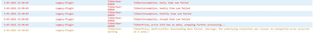

3.03.2021 20:30:01
Legacy-Plugin
TibberSeer ERROR
TibberConsumption, Daily time sum failed
3.03.2021 20:30:01
Legacy-Plugin
TibberSeer ERROR
TibberConsumption, Weekly time sum failed
3.03.2021 20:30:01
Legacy-Plugin
TibberSeer ERROR
TibberConsumption, Monthly time sum failed
3.03.2021 20:30:01
Legacy-Plugin
TibberSeer ERROR
TibberConsumption, Annual time sum failed
3.03.2021 20:30:01
Legacy-Plugin
TibberSeer ERROR
TibberPrice, price info has no data, stopping further processing...
3.03.2021 20:30:01
Legacy-Plugin
TibberSeer Warning
TibberPrice, GetPriceInfo: Downloading data failed. (Message: Den underliggende tilkoblingen Det oppstod en uventet feil under sending ble lukket.)
Endret av Mobile26
