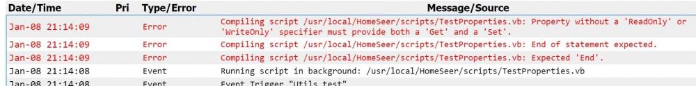

TestProperties.vb
Sub Main(parm as object)
    Dim t as new TestClass
    t.TestProperty = "This is a test"
    hs.Writelog("TestProperty", t.TestProperty)
End Sub
Public Class TestClass
    Public Property TestProperty as String
    Public Sub New()
    End Sub
End Class
.. Skal gi
... i loggen.
Ja, ser ikke ut til at "kort-versjonen" av Property fungerer i mono.. fungerte fint da jeg skrev dem fullt ut:
End Sub
    Private _testProperty as String
        Get
            Return _testProperty
        End Get
        Set(ByVal value as String)
            _testProperty = value
        End Set
    End Property
    Public Sub New()
    End Sub
End Class
