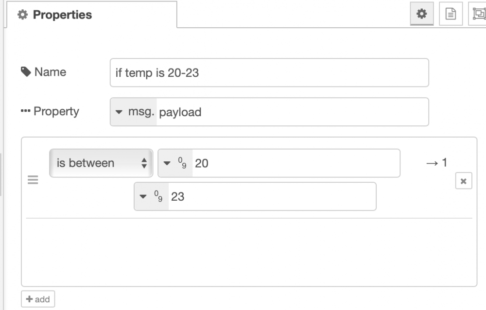

Hei ! Kan noen hjelpe meg med automasjon. Jeg vil slå på og av varmepumpe med Fibaro temp sensor. Temp viser i events: state node ,men "undefine "status i debug node.
[{"id":"f7e02947.452108","type":"tab","label":"fibaro temp test","disabled":false,"info":""},{"id":"49d04e81.512a2","type":"server-state-changed","z":"f7e02947.452108","name":"stue temp","server":"2bb542db.1de8ee","version":1,"exposeToHomeAssistant":false,"haConfig":[{"property":"name","value":""},{"property":"icon","value":""}],"entityidfilter":"sensor.stue_bevegelsessensor_temperature","entityidfiltertype":"exact","outputinitially":true,"state_type":"num","haltifstate":"","halt_if_type":"num","halt_if_compare":"is","outputs":1,"output_only_on_state_change":false,"for":0,"forType":"num","forUnits":"minutes","ignorePrevStateNull":false,"ignorePrevStateUnknown":false,"ignorePrevStateUnavailable":false,"ignoreCurrentStateUnknown":false,"ignoreCurrentStateUnavailable":false,"x":60,"y":120,"wires":[["8615558.d9a90a8"]]},{"id":"8615558.d9a90a8","type":"switch","z":"f7e02947.452108","name":"if temp is 20-23","property":"payload.temperature","propertyType":"msg","rules":[{"t":"lte","v":"20","vt":"num"},{"t":"gte","v":"23","vt":"num"}],"checkall":"false","repair":false,"outputs":2,"x":240,"y":120,"wires":[["2b292ad6.04fa86"],["6b061491.31ef5c"]]},{"id":"2b292ad6.04fa86","type":"change","z":"f7e02947.452108","name":"Set ON","rules":[{"t":"set","p":"payload","pt":"msg","to":"ON","tot":"str"}],"action":"","property":"","from":"","to":"","reg":false,"x":420,"y":60,"wires":[["52e30176.3325a"]]},{"id":"6b061491.31ef5c","type":"change","z":"f7e02947.452108","name":"Set OFF","rules":[{"t":"set","p":"payload","pt":"msg","to":"OFF","tot":"str"}],"action":"","property":"","from":"","to":"","reg":false,"x":420,"y":180,"wires":[["83266586.8fd128"]]},{"id":"83266586.8fd128","type":"api-call-service","z":"f7e02947.452108","name":"Turn off varmepumpe","server":"2bb542db.1de8ee","version":1,"debugenabled":true,"service_domain":"climate","service":"turn_off","entityId":"climate.varmepumpe_stue","data":"","dataType":"json","mergecontext":"","output_location":"","output_location_type":"none","mustacheAltTags":false,"x":620,"y":180,"wires":[[]]},{"id":"52e30176.3325a","type":"api-call-service","z":"f7e02947.452108","name":"Turn on varmepumpe","server":"2bb542db.1de8ee","version":1,"debugenabled":true,"service_domain":"climate","service":"turn_on","entityId":"climate.varmepumpe_stue","data":"","dataType":"json","mergecontext":"","output_location":"","output_location_type":"none","mustacheAltTags":false,"x":620,"y":60,"wires":[[]]},{"id":"2bb542db.1de8ee","type":"server","name":"Home Assistant","legacy":true,"addon":true,"rejectUnauthorizedCerts":true,"ha_boolean":"y|yes|true|on|home|open","connectionDelay":true,"cacheJson":true}]

Nr 1: Ville nok ha endret state node til en poll node, men du får selv vurdere det..
Nr 2: På switch noden, endre msg.payload.temperature til msg.payload, og da vil det nok fungere, om ikke endrer du også fra " <= >=" til "is between"..
