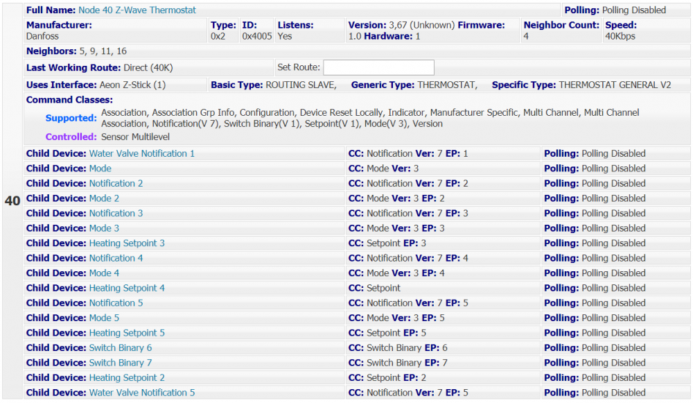

Da hentet jeg Danfoss HC 5 (samme som HC 10, men med 5 utganger). Jeg har lagt den til i HS nå, log nedenfor. Jeg klarer kun å koble opp 4 av 5 utganger, usikker på hvorfor.
Spoiler
des-21 19:25:59   Z-Wave Root Node Device Node 40 Z-Wave Thermostat was created for node 40 on network CB2D85E4
des-21 19:25:59   Z-Wave All associations for node 40 have been retrieved successfully, it supports associations on these groups: 1.
des-21 19:25:59   Z-Wave Node 40 Association Group 1 can have 1 associations, and currently has 0
des-21 19:25:59   Z-Wave Getting association information for node 40
des-21 19:25:59   Z-Wave Node 40 Supports Thermostat Setpoint CC and supports these setpoints: Heating 1
des-21 19:25:59   Z-Wave Processing Information for Node 40 Multi-CHANNEL Command Class of SWITCH_BINARY, Endpoint 7
des-21 19:25:59   Z-Wave Processing Information for Node 40 Multi-CHANNEL Command Class of SWITCH_BINARY, Endpoint 6
des-21 19:25:59   Z-Wave Warning Node 40, EndPoint=5 Multilevel Sensor Report was not received (B) - the child device will NOT be configured properly.
des-21 19:25:59   Z-Wave Processing Information for Node 40 Multi-CHANNEL Command Class of SENSOR_MULTILEVEL_V7, Endpoint 5
des-21 19:25:59   Z-Wave Processing Information for Node 40 Multi-CHANNEL Command Class of THERMOSTAT_SETPOINT, Endpoint 5
des-21 19:25:59   Z-Wave Node 40 Supports Thermostat Mode CC and supports these modes: Off, Heat
des-21 19:25:59   Z-Wave Processing Information for Node 40 Multi-CHANNEL Command Class of THERMOSTAT_MODE_V2, Endpoint 5
des-21 19:25:59   Z-Wave Processing Information for Node 40 Multi-CHANNEL Command Class of NOTIFICATION_V6, Endpoint 5
des-21 19:25:59   Z-Wave Warning Node 40, EndPoint=4 Multilevel Sensor Report was not received (B) - the child device will NOT be configured properly.
des-21 19:25:59   Z-Wave Processing Information for Node 40 Multi-CHANNEL Command Class of SENSOR_MULTILEVEL_V7, Endpoint 4
des-21 19:25:59   Z-Wave Processing Information for Node 40 Multi-CHANNEL Command Class of THERMOSTAT_SETPOINT, Endpoint 4
des-21 19:25:59   Z-Wave Processing Information for Node 40 Multi-CHANNEL Command Class of THERMOSTAT_MODE_V2, Endpoint 4
des-21 19:25:59   Z-Wave Processing Information for Node 40 Multi-CHANNEL Command Class of NOTIFICATION_V6, Endpoint 4
des-21 19:25:59   Z-Wave Warning Node 40, EndPoint=3 Multilevel Sensor Report was not received (B) - the child device will NOT be configured properly.
des-21 19:25:59   Z-Wave Processing Information for Node 40 Multi-CHANNEL Command Class of SENSOR_MULTILEVEL_V7, Endpoint 3
des-21 19:25:58   Z-Wave Processing Information for Node 40 Multi-CHANNEL Command Class of THERMOSTAT_SETPOINT, Endpoint 3
des-21 19:25:58   Z-Wave Error Node 40 Supports the Thermostat Mode Command Class, but failed to return a list of supported thermostat modes - cannot continue.
des-21 19:25:58   Z-Wave Processing Information for Node 40 Multi-CHANNEL Command Class of THERMOSTAT_MODE_V2, Endpoint 3
des-21 19:25:58   Z-Wave Processing Information for Node 40 Multi-CHANNEL Command Class of NOTIFICATION_V6, Endpoint 3
des-21 19:25:58   Z-Wave Warning Node 40, EndPoint=2 Multilevel Sensor Report was not received (B) - the child device will NOT be configured properly.
des-21 19:25:58   Z-Wave Processing Information for Node 40 Multi-CHANNEL Command Class of SENSOR_MULTILEVEL_V7, Endpoint 2
des-21 19:25:58   Z-Wave Node 40 Supports Thermostat Setpoint CC and supports these setpoints: Heating 1
des-21 19:25:58   Z-Wave Processing Information for Node 40 Multi-CHANNEL Command Class of THERMOSTAT_SETPOINT, Endpoint 2
des-21 19:25:58   Z-Wave Node 40 Supports Thermostat Mode CC and supports these modes: Off, Heat
des-21 19:25:58   Z-Wave Processing Information for Node 40 Multi-CHANNEL Command Class of THERMOSTAT_MODE_V2, Endpoint 2
des-21 19:25:58   Z-Wave Processing Information for Node 40 Multi-CHANNEL Command Class of NOTIFICATION_V6, Endpoint 2
des-21 19:25:58   Z-Wave Warning Node 40, EndPoint=1 Multilevel Sensor Report was not received (B) - the child device will NOT be configured properly.
des-21 19:25:58   Z-Wave Processing Information for Node 40 Multi-CHANNEL Command Class of SENSOR_MULTILEVEL_V7, Endpoint 1
des-21 19:25:58   Z-Wave Processing Information for Node 40 Multi-CHANNEL Command Class of THERMOSTAT_SETPOINT, Endpoint 1
des-21 19:25:58   Z-Wave Processing Information for Node 40 Multi-CHANNEL Command Class of THERMOSTAT_MODE_V2, Endpoint 1
des-21 19:25:58   Z-Wave Processing Information for Node 40 Multi-CHANNEL Command Class of NOTIFICATION_V6, Endpoint 1
des-21 19:25:57   Z-Wave Node 40 is Z-Wave version: Lib: 3,67 App: 1.0
des-21 19:25:57   Z-Wave Node: 40 Controls Class(es): SENSOR_MULTILEVEL_V7
des-21 19:25:57   Z-Wave Node: 40 Supports Class(es): ASSOCIATION_V2, ASSOCIATION_GRP_INFO_V2, CONFIGURATION_V4, DEVICE_RESET_LOCALLY, INDICATOR_V2, MANUFACTURER_SPECIFIC_V2, MULTI_CHANNEL_V3, MULTI_CHANNEL_ASSOCIATION_V3, NOTIFICATION_V6, SWITCH_BINARY, THERMOSTAT_SETPOINT, THERMOSTAT_MODE_V2, VERSION_V2
des-21 19:25:57   Z-Wave Z-Wave manufacturer information for node 40, ID: 2=2H (Danfoss), Type: 2=2H, ID: 16389=4005H
des-21 19:25:57   Z-Wave Synchronize nodes finished. Number of device nodes to be created/added = 1
des-21 19:25:46   Z-Wave Done. Node 40 Added.

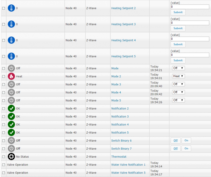

Her er devices HS legger opp:
Det gikk ikke helt som forventet. Jeg koblet den til litt før kl 20 igår kveld og satte utgangene på 'heat' i ca 15 min, deretter på 'off'
Jeg våknet opp til varmt rom, det ser ikke ut til at det skjer noe når jeg setter utgangene til on/off. Nytt forsøk ikveld :-)
Det viser seg at ventilene/aktuatorene er NO (normally open) når de ikke har strøm. Fordeleren er omvendt, dvs NC (normally closed). Endres i root-devicen.
