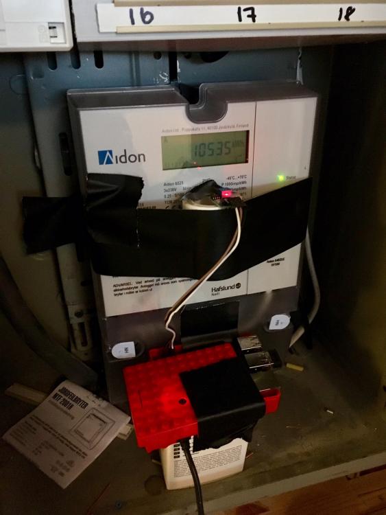

  1. NodeMCU er egentlig morsommere, da kan man havne ned på 50-lappen i utstyr kanskje. Har imidlertid aldri prøvd en NodeMCU, så dette var kjappere for meg å få i gang ? It's a Unix system, I know this! Ser gjerne shoppingliste og kode for NodeMCU! Mitt koblingsskjema er herfra: http://www.uugear.com/portfolio/using-light-sensor-module-with-raspberry-pi/ Kjøpte en LM393 fra denne karen på FINN: https://www.finn.no/bap/forsale/ad.html?finnkode=72376538 Python-kode vedlagt under. Jeg programmerer vanligvis ikke i Python, men how hard can it be? import sys,time import RPi.GPIO as GPIO import paho.mqtt.client as mqtt import paho.mqtt.publish as publish # Variables pulses_per_kwh = 1000 # GPIO setup GPIO.setmode(GPIO.BCM) GPIO.setup(4, GPIO.IN, pull_up_down=GPIO.PUD_UP) # MQTT Broker = "10.0.42.101" Broker_port = 1883 sub_topic = "godlia/meter" pub_topic = "godlia/kw" # when connecting to mqtt do this; def on_connect(client, userdata, flags, rc): print("MQTT connected with result code "+str(rc)) client.subscribe(sub_topic) # when receiving a mqtt message do this; def on_message(client, userdata, msg): message = str(msg.payload) # Future functionality, maybe to control reporting frequency print(msg.topic+" "+message) def on_publish(mosq, obj, mid): print("mid: " + str(mid)) client = mqtt.Client() client.on_connect = on_connect client.on_message = on_message client.connect(Broker, Broker_port, 60) client.loop_start() prevtime = time.time() prevkw = -20 while True: # wait for a rising edge (optional timeout is in milliseconds) channel = GPIO.wait_for_edge(4, GPIO.RISING) if channel is None: print('Timeout occurred') else: nowtime = time.time() diff = nowtime - prevtime prevtime = nowtime kw = 3600 / (diff * pulses_per_kwh) print("{} {}kW".format(round(diff,4), round(kw,2) )) if kw < (prevkw + 10): # If there is more than a 10kW jump, don't send the value # This smooths out most errors in measurement data = '{"kw": '+ str(kw) +'}' client.publish(pub_topic, str(data)) prevkw = kw

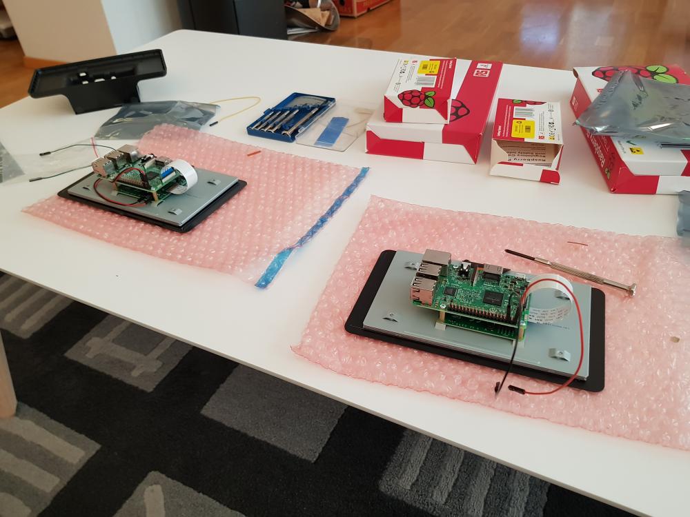

  2. Har satt opp DIY strømmåling i sikringsskapet. En LM393 lyssensor står over den blinkende LEDen på strømmåleren. Den blinker 1000ggr pr kWh, så da er det en smal sak å regne ut kW akkurat nå basert på tiden mellom blinkene. Sensoren er plugget inn i en Raspberry Pi 3, med et Python-script som beregner kW og pusher dette ut via MQTT til Mosquitto-brokeren på hoved-RPi-en (som kjører HomeSeer) Display er veldig enkelt foreløpig, en tablet med eget HTML/CSS-interface kobler seg til MQTT-brokeren og lytter på strømmålerens kanal. Det oppdateres ca. hvert 2. sekund. Planen er å lage et litt mer fancy interface, kanskje med en speedometer-style klassisk strømmåler rundt tallene, og en graf som viser forbruk over tid. Vurderer å dytte data inn i emonCMS for dette. Har ikke satt den opp til å dytte data inn i HomeSeer ennå, men det burde være enkelt med MQTT-plugin der, eller kanskje det er bedre at HomeSeer leser fra emonCMS. Når det blir effektbasert prising kan jeg benytte dette til å automatisk skru av gulvvarmen når forbruket i huset blir for høyt, typisk når man lager mat etc. Har også en plan om å gjøre det litt vakrere i sikringsskapet ? Har bestilt en Raspberry Pi Zero W for å få ned størrelsen og vurderer å løsrive selve dioden fra LM393-kortet, så den kan monteres inne i en gummiring e.l. litt mer diskret over den blinkende LEDen.

  5. Jeg endte opp med å koble asus og 4g ruteren sammen trådløst. Endret apn på modemet og det fungerer godt med ddns :-) Sent from my ONE A2001 using Tapatalk

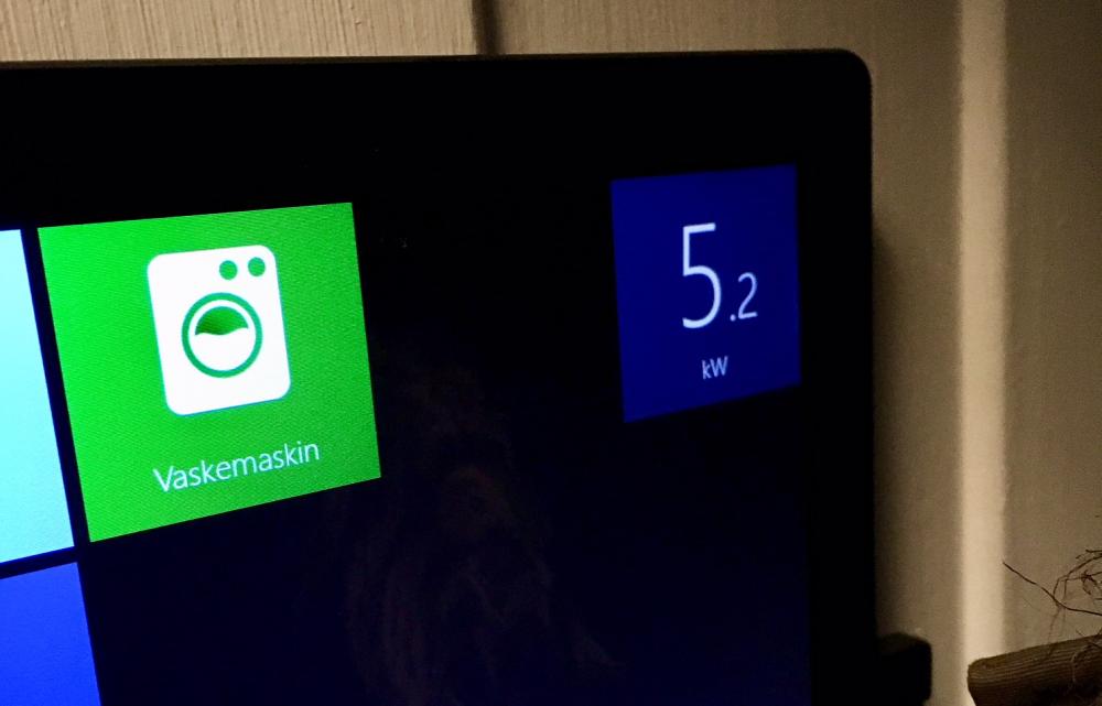

  7. Fant ut at det enkleste for min del (uten scripting) var en NodeMCU med ESPEasy-firmware, konfigurert med "P003 - Generic - Pulse counter". Koblet den opp med en vanlig LDR og en 10k motstand. Rapporterer blink via MQTT til Homeseer som igjen beregner momentanforbruket(W) for de siste 10s. Rapporterer også til Domoticz via MQTT som gir litt mer total beregning av kWh, både dagens og historikk. Ikke fått disse dataene over til HS enda, men mulig HS kan ordne dette selv med et script eller lignende for dere som er flinkere på sånt. ?

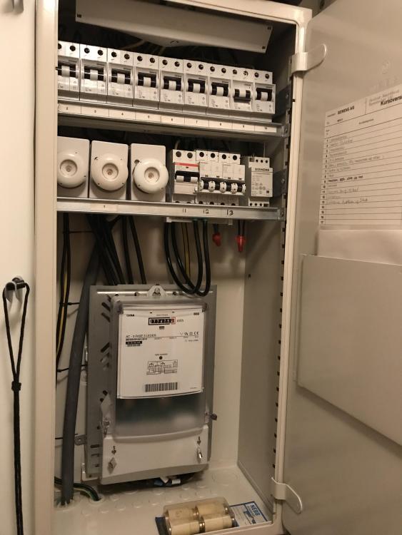

  10. Oppgradert sikringsskapet fra til Dette sparer jeg 100 kr i året på på forsikringen...
