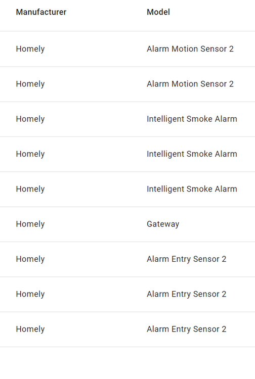

  1. Med siste nye versjon som kom via https://hub.docker.com/r/yusijs/homely-mqtt/ på Unraid i dag, så flasher bevegelsesensor i HA når det er bevegelse i rommet.
  2. Plutselig har mine enheter dukket opp på HA. Etter oppdatering i helgen tror jeg. Både Unraid og HA har fått oppdateringer.

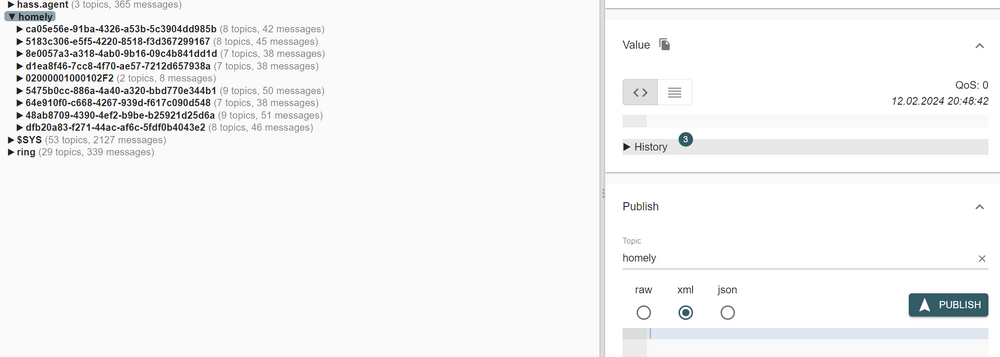

  3. Har nå fått testet. Stopper opp etter å ha lagt inn Brannvarsler. Ser på MQTT Explorer at den ikke legger inn fire som sensor på HA. Den ligger i Homely
  4. Ikke noen config message på fire her heller, kanskje den som stopper videre import av enheter? Hvordan får jeg fjernet alle enheter og legge de til på nytt? Finner config under home-assistant, ingen under Homely topic.
  5. Får masse som published men finner ikke noe configuration. Hvilke logger skal jeg lete i? MQTT loggen i HA eller noen logger i docker? [16:02:14.680] DEBUG (1): Marked Contact as published [16:02:14.722] DEBUG (1): Marked Tamper as published [16:02:14.751] DEBUG (1): Marked Battery low as published [16:02:14.769] DEBUG (1): Marked Battery voltage as published [16:02:14.790] DEBUG (1): Marked Networklink address as published [16:02:14.812] DEBUG (1): Marked Networklink strength as published [16:02:14.833] DEBUG (1): Marked Temperature as published [16:02:14.874] DEBUG (1): Marked Contact as published [16:02:14.909] DEBUG (1): Marked Tamper as published [16:02:14.929] DEBUG (1): Marked Battery low as published [16:02:14.950] DEBUG (1): Marked Battery voltage as published [16:02:14.968] DEBUG (1): Marked Networklink address as published [16:02:14.989] DEBUG (1): Marked Networklink strength as published [16:02:15.007] DEBUG (1): Marked Temperature as published [16:02:15.025] DEBUG (1): Marked Fire as published [16:02:15.048] DEBUG (1): Marked Battery low as published [16:02:15.070] DEBUG (1): Marked Battery voltage as published [16:02:15.088] DEBUG (1): Marked Networklink address as published [16:02:15.124] DEBUG (1): Marked Networklink strength as published [16:02:15.146] DEBUG (1): Marked Temperature as published [16:02:15.165] DEBUG (1): Marked Fire as published [16:02:15.183] DEBUG (1): Marked Battery low as published [16:02:15.201] DEBUG (1): Marked Battery voltage as published [16:02:15.221] DEBUG (1): Marked Networklink address as published [16:02:15.241] DEBUG (1): Marked Networklink strength as published [16:02:15.264] DEBUG (1): Marked Temperature as published [16:02:15.283] DEBUG (1): Marked Fire as published [16:02:15.301] DEBUG (1): Marked Battery low as published [16:02:15.321] DEBUG (1): Marked Battery voltage as published [16:02:15.350] DEBUG (1): Marked Networklink address as published [16:02:15.373] DEBUG (1): Marked Networklink strength as published [16:02:15.394] DEBUG (1): Marked Temperature as published [16:02:15.412] DEBUG (1): Marked Motion as published [16:02:15.431] DEBUG (1): Marked Tamper as published [16:02:15.451] DEBUG (1): Marked Battery defect as published [16:02:15.492] DEBUG (1): Marked Battery low as published [16:02:15.510] DEBUG (1): Marked Battery voltage as published [16:02:15.530] DEBUG (1): Marked Networklink address as published [16:02:15.550] DEBUG (1): Marked Networklink strength as published [16:02:15.568] DEBUG (1): Marked Temperature as published [16:02:15.589] DEBUG (1): Marked Motion as published [16:02:15.618] DEBUG (1): Marked Tamper as published [16:02:15.644] DEBUG (1): Marked Battery defect as published [16:02:15.672] DEBUG (1): Marked Battery low as published [16:02:15.713] DEBUG (1): Marked Battery voltage as published [16:02:15.731] DEBUG (1): Marked Networklink address as published [16:02:15.760] DEBUG (1): Marked Networklink strength as published [16:02:15.781] DEBUG (1): Marked Temperature as published [16:02:15.802] DEBUG (1): Marked Contact as published [16:02:15.826] DEBUG (1): Marked Tamper as published [16:02:15.858] DEBUG (1): Marked Battery low as published [16:02:15.879] DEBUG (1): Marked Battery voltage as published [16:02:15.899] DEBUG (1): Marked Networklink address as published [16:02:15.921] DEBUG (1): Marked Networklink strength as published [16:02:15.940] DEBUG (1): Marked Temperature as published [16:02:15.958] DEBUG (1): Marked Gateway as published
  6. Finner ikke noe slikt. Jeg er sikkert litt dum. Vil ha ting plug'n'play helst.
  7. Har nå fått inn enhetene i MQTT explorer med homely som Topic. Prøver å lytte på MQTT homely qos 1

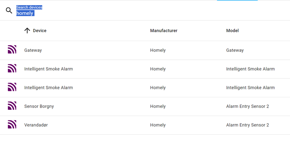

  8. Har samme problem med antall enheter. (6 stk) Finner ikke noen flere enheter med MQTT Explorer mot Home Assistant. Lagt til bevegelsessensor. Så tror problemet ligger i Docker image. Finner ikke noen error i loggen til Mosquito Broker.
  9. LØST: Har noen klart å sette opp homely-mqtt inne i HA eller på Unraid? Jeg får ikke til dette. Dette løste det for meg. Tusen takk @BalleClorin og @Ronniehl. Da må jeg bare finne ut hvordan jeg får koblet ting riktig i Home Assistant. Edit: Enkelt....Enhetene faller inn en etter en.
