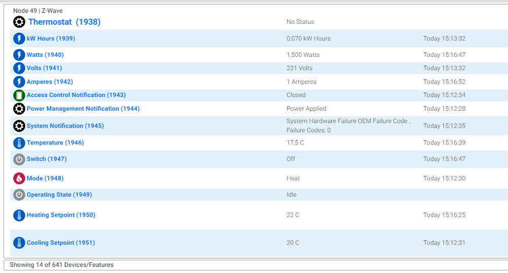

  2. status endres i HS, men ikke på termostaten. den slår heller ikke ut/inn om jeg går over/under aktuell temperatur. stiller jeg opp eller ned fysisk på termostaten endres status i HS.
  3. Lagt inn unsecure ja. prøvde på nytt nå. samme som Actibus, HS oppdaterer value når jeg stiller fysisk på termostaten, men ikke omvendt. av og på styrt fra HS funker også. så kan vel bruke temperaturdevicen og styre bryteren fra HS kanskje ? men 13 av 14 child devicer? kan det bety noe rart? Add Node started... Activate the 'Add to Network' function on the device... Activate the 'Add to Network' function on the device... A new node is being added... Adding a new SLAVE NODE... DONE - Add Node Operation is Complete. Done. Node 49 Added. Reloading (importing) node information... Synchronizing node information with HomeSeer and creating new device(s) as necessary... Synchronize nodes finished. Number of device nodes to be created/added = 1 Z-Wave manufacturer information for node 49, ID: 1080=438H (UNKNOWN), Type: 4=4H, ID: 264=108H Node: 49 Supports Class(es): VERSION, ZWAVEPLUS_INFO, ASSOCIATION, MULTI_INSTANCE_ASSOCIATION, ASSOCIATION_GRP_INFO_V2, TRANSPORT_SERVICE, DEVICE_RESET_LOCALLY, MANUFACTURER_SPECIFIC_V2, SWITCH_BINARY, SENSOR_MULTILEVEL_V8, PROTECTION, METER_V2, NOTIFICATION_V6, CONFIGURATION, THERMOSTAT_MODE_V3, THERMOSTAT_OPERATING_STATE_V2, THERMOSTAT_SETPOINT, TIME, TIME_PARAMETERS, INDICATOR, POWERLEVEL, SUPERVISION, FIRMWARE_UPDATE_MD Node 49 is Z-Wave version: Lib: 7,16 App: 10.22 Node 49 is a Z-Wave Plus node. Retrieving ZWPlus Info... Node 49 Supports 3 Notification Types: Access_Control Power_Management System Access_Control Supports Events: Open(22), Closed(23) Power_Management Supports Events: Power Applied(1) System Supports Events: System Hardware Failure OEM Failure Code(3) Node 49 Supports Thermostat Mode CC and supports these modes: Off, Heat, Cool Node 49 Supports Thermostat Setpoint CC and supports these setpoints: Heating 1, Cooling 1 All associations for node 49 have been retrieved successfully, it supports associations on these groups: 1. Root Node Device Node 49 Z-Wave Thermostat was created for node 49 on network F6E18D88 AEOTEC: Adding association for Z-Wave device Node 49 Z-Wave Thermostat (Node 49, Group 1) to HomeSeer 13 out of 14 Child devices of node 49 were created successfully. Finished. Saving network information to file: Network F6E18D88_F6E18D88_2023-03-10_15.12.01.nodes. Please wait... Done!
