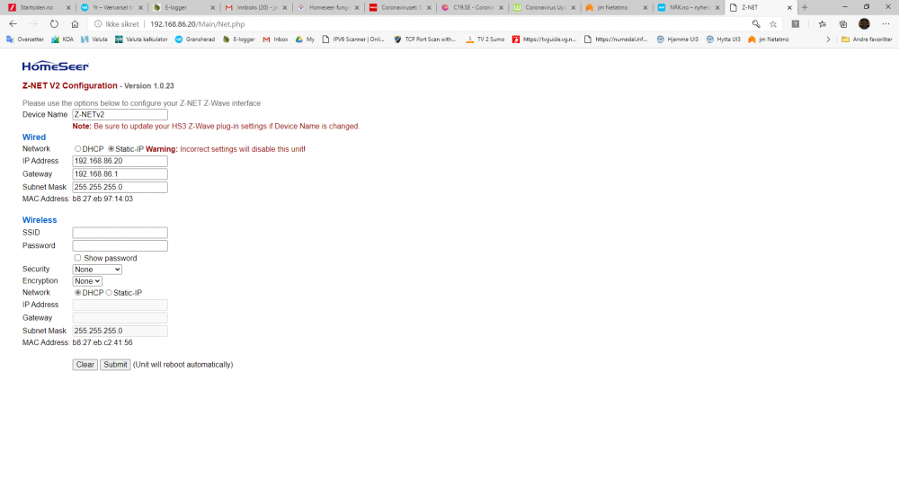

  18. Ikke mye å konfigurere her, bare DHCP eller statisk IP.

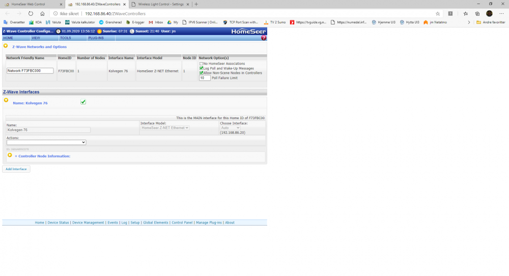

  22. Nei, de er ikke like, se nedenfor: Ny file F73FBC00 1 1,211,22,1,2,2,1 Gammel file F73FBC00 1 1,211,150,1,2,2,1 2,83,156,1,4,7,1 3,211,156,0,4,16,1 4,211,156,1,4,17,1 5,83,156,1,4,33,1 7,83,220,1,4,64,3 8,83,220,1,4,64,3 9,211,156,0,4,16,0 10,211,156,1,4,17,1 12,211,156,1,4,17,1 13,211,156,1,4,17,1 14,211,156,1,4,17,1 15,211,156,0,4,16,0 16,211,156,0,4,16,1 20,211,156,1,4,17,1 22,211,156,1,4,17,1 24,211,156,0,4,17,6 25,211,156,0,4,17,6 26,211,156,0,4,16,1 27,211,156,0,4,16,0 28,211,156,0,4,16,0 30,211,156,0,4,16,1 31,211,156,0,4,16,1 33,211,156,1,4,8,6 34,211,156,0,4,16,1 35,211,156,0,4,16,0 36,211,156,0,4,16,0 37,211,156,1,4,17,1 38,83,156,1,4,7,1 39,211,156,1,4,7,1 40,211,156,0,4,16,0 41,83,156,1,4,7,1 42,83,156,1,4,7,1 43,211,156,1,4,17,7 44,83,156,1,4,7,1 45,83,156,0,4,32,1 46,83,156,1,4,7,1 48,83,156,0,4,32,1 50,211,156,1,4,64,7 51,211,156,0,4,16,0 52,211,156,0,4,16,0 53,211,156,0,4,16,0 54,83,156,1,4,24,1 57,83,156,1,4,33,1 58,83,156,1,4,7,1 59,19,150,1,1,1,1 60,211,156,1,4,16,1 63,211,156,1,4,17,7 64,211,156,1,4,17,7 67,211,156,1,4,17,1
  23. Kommer her
  24. Da har jeg lagt tilbake en gammel backup, og da ser det slik ut. Det er samme HomeID. Det er mulig på grunn av at jeg benyttet samme IP adresse på den nye blå Z-net når jeg la inn denne.
